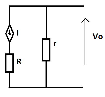

Vo=? In terms of the given. This is the attached figure

If the head of the Vo arrow is supposed to be the positive end, then Vo = minus I times little r = -(I * r)
This is because the current is flowing upwards in the right hand side of the loop, so the bottom of the resistor r is positive.
-I*r = Vo.
I see what you guys are saying...but if you remove little r...the voltage is still the same!
Little r has no bearing on v out in my opinion.

looks to me like if you open little r you have opened the load on a current source, so the voltage will become the maximum the source can produce.
Infinite, for "ideal" source .
So it's little r not big R determines Vo in that circuit.
It helps to put some real sizes on the components:
Let R = 20 ohms, r = 30 ohms and the current source = 1 amp.
Like this:
http://dl.dropbox.com/u/4222062/current%20gen.PNG
So, the voltage across the resistor "r" = Vo = (1 amp * 30 ohms) = 30 volts (Negative 30 volts relative to the arrow)
So, the voltage across the resistor "R" = (1 amp * 20 ohms) = 20 volts
With this load, the voltage across the current source is 50 volts (1 amp * (30 ohms + 20 ohms)) and you can get the same result if you regard the resistors as part of a voltage divider.

Perhaps I can answer this...I can see how the current device has 50 volts across it.
I guess it drops 20 volts across R...leaving 30 volts across each branch.
Must be since the voltmeter is not going to change branch to branch.
Yes, that's right, the 50 volts across the current source is partially canceled by the 20 volts across the 20 ohms resistor (because they have opposite polarities in the left hand leg of the loop), so this leaves 30 volts between the top and bottom of the diagram.

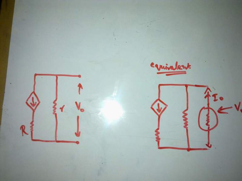

i think answer should be IR !
suppose there are terminals in at the ends of r resistance , that would'nt be in series then and it did not asked for the voltage drop at r it asked for V(0) which would be equal to current in small r when small r and capital R are parallel!
I'm not able to picture what you mean. Can you draw it?

Here is the same circuit as above but redrawn in a more familiar way:
http://dl.dropbox.com/u/4222062/series%202.PNG
The question asked for the voltage ACROSS the 30 ohm resistor, "r". That is, what voltage would you measure with a voltmeter?
ya i got it ! i was confused there ! thanks !
