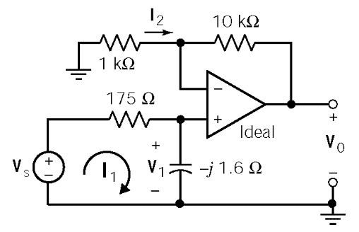

Determine the output voltage Vo(t) in terms of Vs
If I were to use Nodal Analysis to solve this, would these be the proper nodal equations?[tex]\frac{V1}{-j1.6} + \frac{V1-Vs}{175} = 0[/tex]
[tex]\frac{V_{I2}-Vo}{10k} + \frac{V_{I2}}{1k} = 0[/tex]
Sure, those would be a good start.
Is V1 = V2?
eehelp150 said:
Is V1 = V2?
Well, it's an ideal op amp with feedback to the negative input. So that would be a yes.
I end up with:
j25.45Vo + 0.233Vo = 2.56Vs
Does this look good so far?
I think that looks okay. Hard to tell without seeing the full derivation, but it certainly yields a result for Vo that's almost spot on compared to what I calculate.

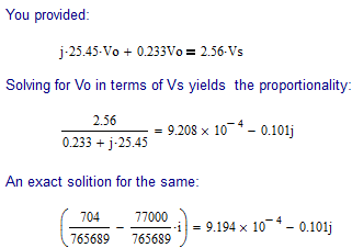

How far off am I compared with your results?
Within plausible rounding error range. The expression you provided was not in a typical final form, since Vo was not isolated. So I "solved" it for Vo in terms of Vs and compared the proportionality constant with what I derived. Here:
