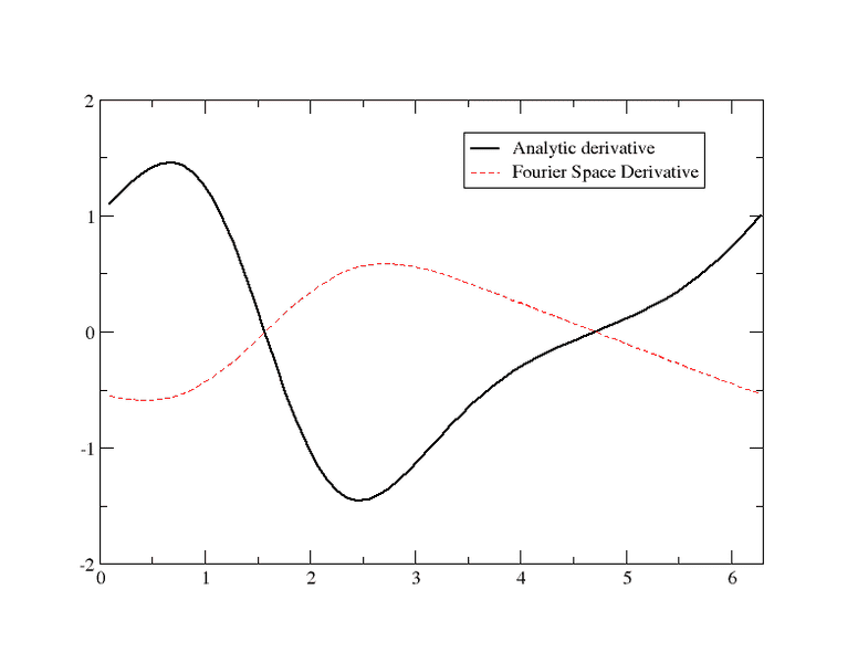

Hi, this thread is an extension of this one: https://www.physicsforums.com/posts/5829265/
As I've realized that the problem is that I don't know how to properly use FFTW, from http://www.fftw.org.
I am trying to calculate a derivative using FFTW. I have ##u(x)=e^{\sin(x)}##, so ##\frac{du(x)}{dx}=\cos(x) e^{\sin(x)}##.
By using the Fourier series I have that: ##u(x)=\displaystyle \sum_{k=- \infty}^{ \infty}\hat u_k e^{ikx}##,
So I must also have: ##\frac{du(x)}{dx}=\displaystyle \sum_{k=- \infty}^{ \infty}ik \hat u_k e^{ikx}##.
I am using that:
##\frac{du(x)}{dx}=\sum_{k=- \infty}^{ \infty} \hat \beta_k e^{ikx}##, with ##\hat \beta_k=ik \hat u_k##.
What I do is, I go to Fourier space, calculate the coefficients of ##u(x)##, multiply by ##ik##, and then I transform back to get the derivative. There are a few things with the FFTW, the first is that the coefficients are unnormalized, so I have to multiply by ##1/N##. I'm not sure if I have to multiply only once, for when I convert from ##u\rightarrow \hat u_k##, or if twice, due to the fact that I am using the coefficients for the derivative ##u\rightarrow \hat u_k\rightarrow \hat \beta_k##.
The other thing has to do with the ordering of the coefficients. In this url: http://www.fftw.org/fftw3_doc/The-1d-Discrete-Fourier-Transform-_0028DFT_0029.html
it says that the coefficients are ordered like:
Note also that we use the standard “in-order” output ordering—the k-th output corresponds to the frequency k/n (or k/T, where T is your total sampling period). For those who like to think in terms of positive and negative frequencies, this means that the positive frequencies are stored in the first half of the output and the negative frequencies are stored in backwards order in the second half of the output. (The frequency -k/n is the same as the frequency (n-k)/n.)
I am using the discrete versions of the Fourier Transform:
##u_k=\frac{1}{N}\displaystyle \sum_{j=0}^{N-1} u(x_j) e^{-ikx_j}##
##u(x_j)=\displaystyle \sum_{k=-N/2+1}^{N/2} \hat u_k e^{ikx_j}##
However, remember that I'm only going back and forth to Fourier space, so I'm not using this formulas, but I have to have into account the normalization factor, and the correct ordering of the coefficients.
Here is the code:

Here is what I obtain:
Thanks in advance.

I fixed it, I was using the wrong values of k.
I've made that mistake the first version of Fourier transform code.
I've gotten in the habit of double checking my Fourier transform code by taking the Fourier transform of some known sine waves to confirm all those details before moving on to inputs where I don't already know what the output should be.
