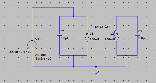

Can you just provide me a spice simulation of a particular stagger tuned circuit at different value of staggering...
I am trying to simulate this circuit but I am confused regarding selecting the component values and how should I select the centre frequency for the tuned circuit and how to stagger them to three different values so that I could compare the result for analysis.
What feature does spice provides for staggering two tuned circuits..
Post your LTspiceFile.asc as LTspiceFile.asc.txt
There must be L, C and R in a tuned circuit to get a finite Q.
please find the file below

For stagger tuning the two resonant circuits are separated by an amplifier. As baluncore says, the resistances in each circuit must be specified and you must include the source resistance. Are you showing a constant voltage source? This would have zero resistance and would prevent the circuit from operating.
My voltage source is a sine wave ac source with AC amplitude of 100 and a dc offset of 1.
You need to know the resistance of the source and ensure that the tuned circuit has the required total value of resistance across it. You also need to use the correct value of resistance across the secondary, and you need to consider the resistance/impedance of the measuring device. You need to separate the two stages using an amplifier. Your voltage of 100 sounds remarkably high and will overload most amplifiers.

Remove the .txt suffix to try this LTspice code. It does a sweep of peak separation to show product of stagger tuning.
Model has a perfect voltage follower Bvf, and duplicates the low frequency side to plot transfer functions of the frequency staggered circuits and the product of the staggered pair.
dB voltage
Linear voltage

Here is a version without the buffer, cut for 5% coupling. See what happens when you change the coupling. Higher coupling locks the resonators and pulls the frequencies out, while lower coupling increases the losses. It demonstrates the advantage of amplifiers.

I think you should build an LTspice model of an IF stage, a two transistor amplifier with a mutually coupled double tuned transformer between the stages. See if you can get a maximally flat pass-band without a sloping top. Match the impedance of the first BJT collector to the primary resonator and the secondary resonator to the base of the second BJT. See how much gain can you get from that one stage of the strip. Then you will understand how to simply design it from scratch.
My whole idea is to first synchronise the resonators to the same centre frequency and then observe the gain ...
in the second step i will vary the capacitance value of the second resonator which will shifts the value of centre frequency and will result in symmetric staggering..now again i will observe the gain..
and in the last step i will follow an asymmetric staggering by shifting centre frequency of second resonator to a different value..
Then a comparison between three curve will be fruitful which may lead me to some conclusion...
Meanwhile I need further help on this simlation as it seems I haven't chosen the component value correctly..
simulation isn't working..
