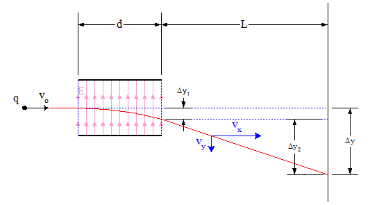

Hi Keith G.,
If you're keen to pursue this problem and work out the full solution, here's a diagram you might be able to make use of:
##\Delta y## is what is sought.
