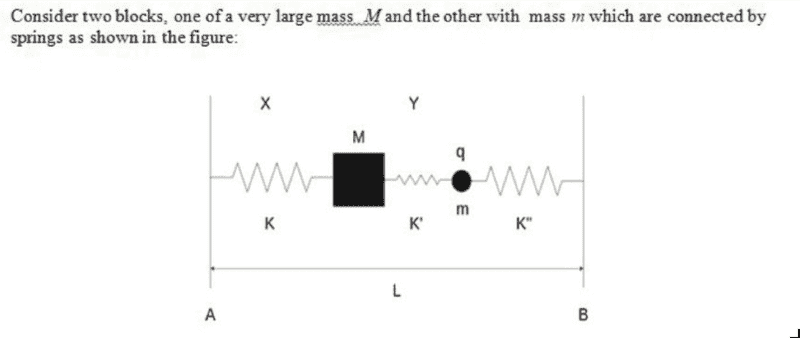

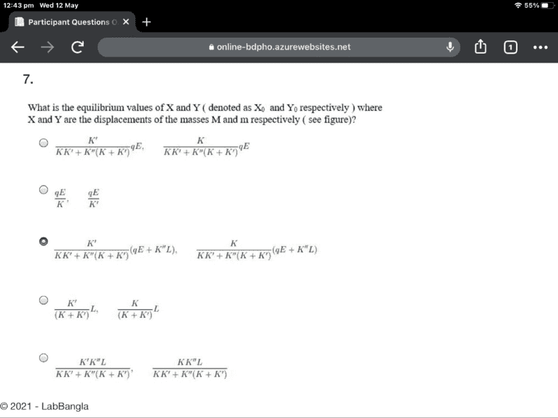

What is the equilibrium values of X and Y (denoted as X0 and Y0 respectively) where X and Y are the displacements of the masses M and m respectively (see figure)?

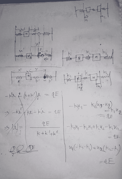

Solution attempt :
The formula F = qE is valid for a force F, a spring constant q and an extension of the spring E In general. They are not used in this problem.
You only need X, Y, L and the spring constants K, K' and K''.
The first 3 answers are wrong for this reason, as is your computation.
You need to use equilibrium of of forces for the M and m masses.
Writing down the equations for equilibrium of forces should be pretty simple, there's no need to consider more than 2 springs and 1 mass at the same time.

The problem made no sense to me. Displacements from what? Usually one refers to displacements as being from equilibrium, making the answer X=Y=0.
Then I noticed the q in the diagram. Looks like E is supposed to be an applied electric field, not shown, and q is a charge on m. That would create a new equilibrium, displaced from the fieldless equilibrium.
This still leaves it a bit unclear how X and Y are defined. They are described as displacements of the masses, but in the diagram they appear associated with the spring lengths.
Interpreting them as increases in spring lengths I get one of the given answers. @Istiakshovon, you seem to have trusted the text and taken them as displacements of the masses. But you have not completed the calculation. You got two equations with two unknowns; now you need to solve them.

To @Istiakshovon: Your equations don't make sense. It seems that you are trying to balance forces, but I see no force expressions. To get a force, you need to multiply a spring constant by a displacement. I see no such terms on the right-hand side of your attempt at a solution. Please try harder.
You may be misreading the handwriting. There are terms like ##k_2x_1##, but the x's look more like k's.
Likes kuruman
Ah, yes. That's what it is. Thanks.

I said in my last thread that I gave all of information. I am saying the same thing for the question also. Actually, this question was for Physics Olympiad (I think everyone knows what it is). They write question as hard as possible. Even, I didn't know that did the question say to find displacement. Those options was looking like finding displacement that's why I just said that. Even, the main examiner told yes either.

Sorry! The exam was taken in online-bdpho.azurewebsites.net . They don't submit those question papers very fast. Maybe, they uploads paper in 8-9 months. Even, I am not sure they submits Regional and, National papers or not. In [this page](https://bdpho.org/index.php/site/past_question_paper.html) they submitted lot of question papers. I think most of them are International Question papers ~ I am not sure cause, I haven't get to Apho (Asian) and, National also.
This above link only displays the word 'Working', greyed-out. Nothing else. How did you get the images in Post#1?

Person who was examiner he had taken screenshot. That page doesn't available anymore.

I'd guess the intended question is something like this...
Call the springs (left to right) 1, 2 and 3 with spring constants k₁, k₂ and k₃ respectively.
[spring 1]M[spring 2][m][spring 3] (see original diagram)
With no electric field the springs are at their natural lengths.
When electric field E is applied, the charge (q) on m causes m to experience a force, qE, to he right. The system reaches a new equilibrium.
M has been displaced right a distance X and m has been displaced right a distance Y.
What are X and Y in terms of k₁, k₂, k₃ q and E?

Solution
Spring 1 is extended a distance X so its tension is k₁X.
Spring 2 is extended a distance Y-X so its tension is k₂(Y-X).
Spring 3 is compressed (assuming no buckling) a distance Y so its compression is k₃Y.
Balancing the forces on M gives: k₁X = k₂(Y-X)
Balancing the forces on m gives: k₂(Y-X) + k₃Y = qE
That’s all the physics done. The rest is algebra - the above 2 equations can be solved to find X and Y. I don’t know if the answer matches any of the answers in the answer-list, but you can give it a try.

My interpretation differs from yours. I agree with you with the setup of the problem and with your definition for X. However, as far as Y is concerned, I think it is the change in length of the middle spring relative to its own relaxed length. In that case, one would have
Spring 2 is extended a distance Y so its tension is k₂Y.
Spring 3 is compressed (assuming no buckling) a distance (X+Y) so its compression is k₃(X+Y).
With this interpretation, one of the given choices matches the answers obtained by solving the system of two equations and two unknowns. That the other four choices cannot be correct, can be independently verified with a little bit of thought.
Physics Olympiad problems may be made difficult but not by withholding information and requiring the solver to divine what was in the author's mind. That is a task best relegated to a haruspex.
