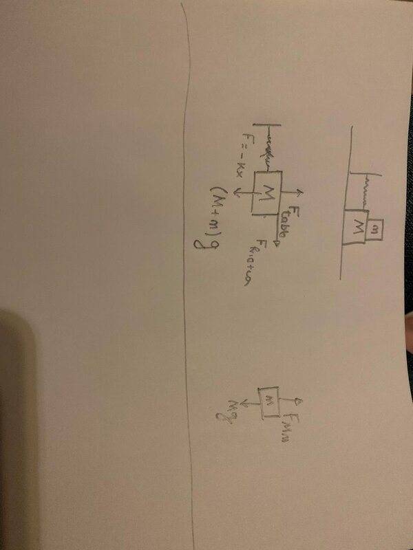

  • Handwritten sketch on paper, rotated, of a block of mass M on a horizontal surface attached to a spring anchored to a wall, with a small block labelled m on top. Below, a free-body diagram labels F = -kx, Ftable, Ffriction, and (M+m)g. A smaller diagram of block m shows Ff,min and Ng.
For the time being let's consider part (a) where there is no friction between block M and the table but there is friction between the two blocks. The problem is asking you to consider what happens immediately after releasing the blocks. Draw the FBDs at that moment. Be sure to show and label all vertical and horizontal forces. Also remember Newton's third law. Action-reaction counterparts must point in opposite direction and have similar labels. Example : Fby B on A is the reaction counterpart of Fby A on B. It really pays to be systematic.

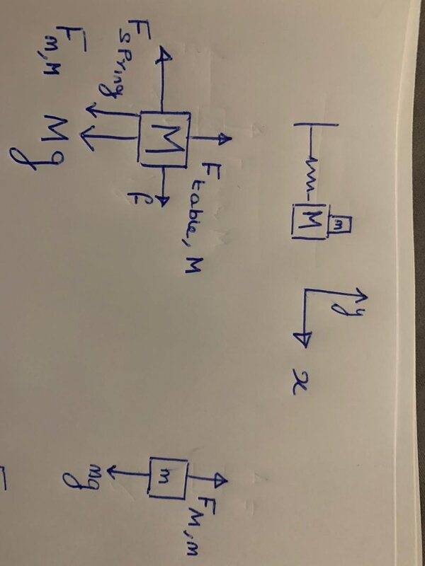

  • Handwritten free-body diagrams for a mass-spring system: a spring attached to block M with small block m on top, with x and y axes, and separate force diagrams for M (F spring, F table M, f, Mg, F m,M) and for m (mg, F M,m).
I assume that the diagram you appended to post #12 is pursuant to the suggestions by @haruspex in post #11 and that the masses accelerate as one. In what direction is the acceleration of the top mass? Does your free body diagram for the top mass show forces that can conceivably be added together to give a net force in that direction?
I showed no forces acting in the horizontal direction on mass m because I don't know the source of the force acting to cause it to accelerate in the same direction as mass M.
Not knowing the source is insufficient reason for not drawing the force because you know that there is a horizontal force. Can you make an educated guess about its origin?
Hint: There are only two items in the universe that interact, i.e. exchange forces, with the top block: the Earth and the bottom block. You have correctly drawn the force exerted by the Earth as vertical. So that leaves ...
I am going to guess with reason, the block of mass M which is connected to the spring has a natural tendency to move towards the equilibrium point so the force of static friction will act accordingly to the right . Whereas for mass m natural state of motion is to remain at a displacement x from equilibrium of the spring hence a force of friction will act to the left.
Yes. The bottom block exerts a force on the top block and the top block exerts a force on the bottom block. These forces have equal magnitudes and opposite directions. The line along which they line is at an angle with respect to the vertical. Each of these forces has a component perpendicular to the interface between the blocks which we call the "normal" component and a component parallel to the interface which we call "friction". Obviously, these components are in opposite directions, a pair along the verticl and a pair along the horizontal.
In view of all this, please redraw your FBDs and post them. If you can write equations expressing Newton's second law based on each FBD. You should have 4 equations, because there are two directions (horizontal and vertical) and two FBDs.

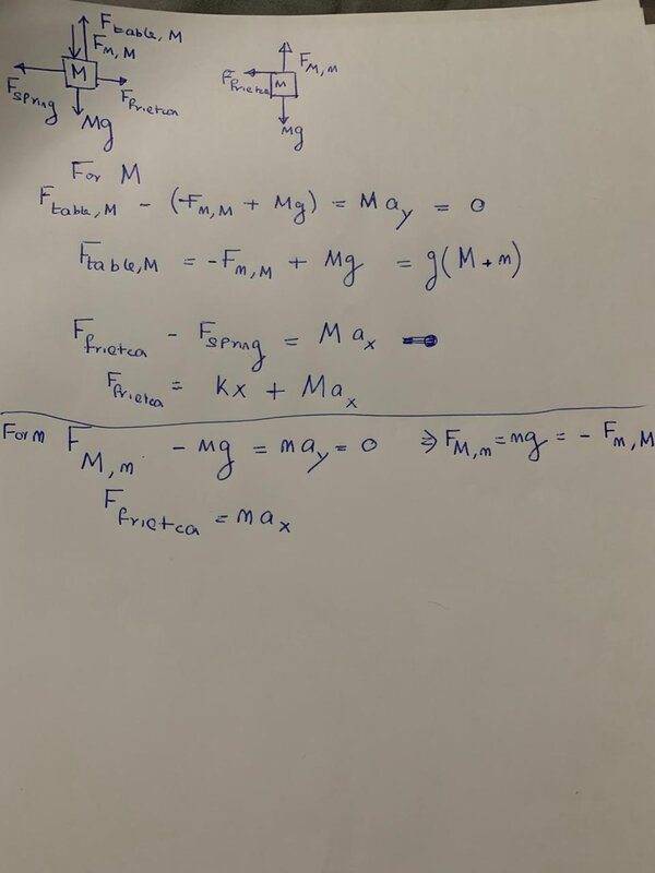

  • Handwritten physics working on lined paper: two free-body diagrams at top for blocks M and m, then force equations for M including F_table,M - (F_M,m + Mg) = Ma_y = 0 and F_friction - F_spring = Ma_x, and for m including F_M,m - mg = ma_y = 0 and F_friction = ma_x.
Much better but the horizontal equation for the bottom mass is inconsistent with your convention that "to the left is negative, to the right is positive". Check your signs, fix the equation, and solve for the horizontal acceleration. Then consider what happens to it when you make the initial extension ##x## of the spring larger and larger.
I equate the force of friction for mass m and M and solved for a. a=-kx/(M+m) as the extension to the right increases the acceleration will also increase but to the left.However, the force of friction itself ranges from zero to some maximum so x is constrained by that maximum.
Very good. For the magnitude of the acceleration you have to remove the negative sign. You can see as x increases, the magnitude of the acceleration increases.
Now can you find the force of static friction between the masses in terms of k, x, m and M?
For mass m the normal force is mg therefore the maximum of the force of static friction mg μ =mkx/(M+m)
