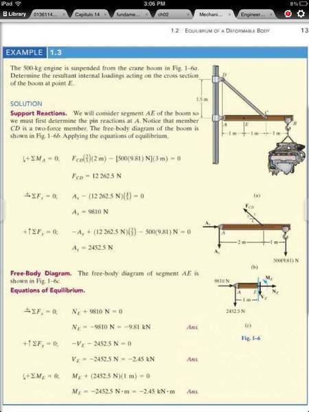

I have a question with this one.
1.Why they didnt considered Fcd(4/5) when calculating moment at A? Is it Because when multiplied by the distance is zero? like so, Fcd(4/5)(0)
2. How do I determine the values of the triangle of Fcd? When I took static I never had to find them. BTW, they are h=5,y=3,x=4
1. Fcd (4/5) is the horizontal component of Fcd. Since it is inline with point A, there is no moment produced about A.
2. Don't you know trigonometry? You can find the component ratios from the sides of the 3-4-5 triangle.
no...
How about Pythagoras?
how do I get an hypotenuse of 5 from square root of 1.5^2+2^2?
You are mixing up different parts of the force Fcd diagram with the dimensions of the frame. The triangle attached to Fcd is 3-4-5, which satisfies the Pythagorean theorem.
The diagonal support measures 2 meters from A to C, and 1.5 meters from A to D.
The distance from D to C is not 5 meters but 2.5 meters. Therefore, triangle ACD is similar to a 3-4-5 triangle. Knowing the magnitude of Fcd (12,262.5 N), you can work out the components by using ratios.
