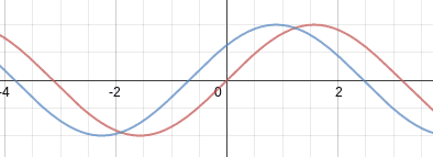

Actually, it's funny that you mention that. We had a lab where we had to do exactly this. I'm not sure if our oscilloscope was special, but the leading waveform was the waveform that was on the left. So for example:
the blue waveform is leading.
Yes, that is a typical result.
You need to understand that this is what you get after a few cycles of input voltage.
When you first apply power to a capacitor, for example, there can't already be a current flowing in the capacitor, although the leading current graph seems to show that.
It takes a few cycles to settle down to a steady pattern.

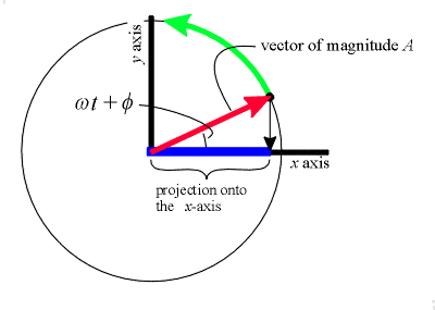

In my day it was the duty of the textbook author to take you through the assumptions that led to that result.
Firstly, these equations apply only to sine waves which, although most common, are a mathematical special case.
I was taught to represent the sine wave voltage as a rotating vector called a "phasor", which rotates counterclockwise.
Phasor's tail is at center of a circle, head lies on its diameter.
Zero degrees was defined as horizontal with head pointing right.
Next teacher explained how sine at any angle of rotation is equal to the vertical distance of phasor's head from horizontal diameter of the circle. That's just Pythagoras and 8th grade geometry...
So voltage at any instant = Asin(ωt) where A is amplitude of your voltage
and a positive angle is in the counterclockwise direction
Now - once you have defined your starting point, ie where is zero and what direction does your phasor rotate , all else falls out.
But it is SOOO easy to dismiss those essential first steps as just "textbook boilerplate" and brush over them,
that astute students like yourself ask "How'd we get here? Which way is up? "
Valid questions, both.
Go back and see if your text addresses these humble beginnings.
http://resonanceswavesandfields.blogspot.com/2007/08/phasors.html
hope I addressed the right question.
