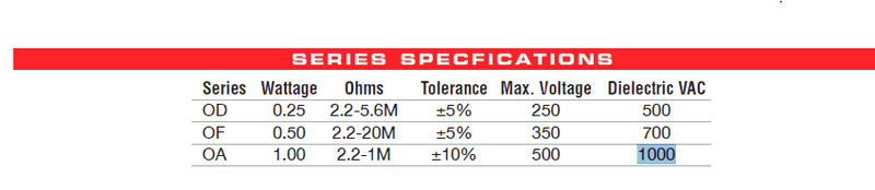

jim hardy said:
It's a volts-per-meter stress limit not a thermal power dissipation limit .
Can you show me some documentation or guide me on this volts per meter thing? This will definitely be important when I choose my resistors. I cannot seem to find this parameter on a datasheet.
Jonathan Mc said:
The circuit that I am going to build will be an instrumentation amplifier with several attenuation stages to scale 800Vrms down to 10Vp. The gain will be auto adjusted in LabVIEW. The students (this project is for upgrading the lab) will not be expected to set the gain manually. I have a prototype built but It is scaled to 120Vrms.
Thanks for your responce!
Ahh ok that should work and I like it.
With a project like that, adding hooks into the labview program for the students the manually adjust the gain (if they choose) might be beneficial as well. As in change the gain via constants or selection in the program. Allowing students to see what happens if you reduce the gain too much (wasted resolution and decrease accuracy) would be a good lesson. With a system like this flexibility is key. Labview is easy to allow for that sort of thing.
Do you know about creepage and clearances? https://resources.altium.com/pcb-design-blog/high-voltage-pcb-design-creepage-and-clearance-distance
There's an old PF thread on that same question https://www.physicsforums.com/threa...sistor-power-rating-and-rated-voltage.735180/
and here's a snip from a resistor datasheet linked in that thread
Table titled SERIES SPECIFICATIONS listing resistor series OD, OF and OA with wattage, ohms range, tolerance, max voltage and dielectric VAC columns; OA dielectric value 1000 is highlighted.
as you see, the 0.25 watt resistor has a maximum voltage of 250.
Now, 250 volts across one megohm = 250^2 /10^6 = 0.0625 watts, ¼ its rated power.
That's a volts per unit length limit on that resistor body .
and here's what i wrote in post # 9 of that thread:
Place yourself for a moment in the shoes of manufacturer.
You have a line of resistor bodies in various body sizes, each capable of dissipating Xsize watts (or milliwatts)
Each size offers resistance values ranging from probably one ohm (or 0.1 ohm) to megohms. And by size is how they're sorted in your catalog.
What is the limiting factor for each body size - watts or volts per inch of the internals ? observe dlgoff's arcing, that's a 1000 word picture if ever there was one. But only in high ohm values will you hit the volts-per-inch limit before the watts limit.
It's unusual in garden-variety circuit design to bump against the volts-per-inch limit because most consumer electronics doesn't have high enough voltage.
So it's not emphasized much in our education .
But the prudent designer is aware of it as just another limit to be observed.
see also http://www.vishay.com/docs/49873/49873_sg2113.pdf
Now you know what to look for in your resistor datasheets, voltage limit for the body size. .
Don't push high ohm resistors all the way to their power limit you'll let their smoke out.old jim
