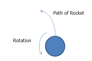

Definitely not scale. Just wondered if this picture captures the concept correctly?
For a rising rocket, Coriolis acceleration is anti-spinward. So if you are trying to represent the trajectory from the viewpoint of the rotating frame, the curvature is in the wrong direction.
If you are trying to represent the trajectory from the viewpoint of an inertial frame, the initial direction is wrong. A slowly rising rocket will start out nearly tangent to the moon's surface since its initial velocity due to rotation will be larger than its vertical velocity.
Note that, initially, when the rocket is sitting on the moon, it already has the same motion as the moon. When it takes of it will, in addition to the upward velocity due to the rocket, it will have a motion tangent to the moons surfact. That will increase its height but also keep it above the point from which it took off.
Looks like it's drawn in the inertial frame and is correct.
In the Inertial frame the rocket starts out going 4.62 m/s to the left. (length moon equator/siderial period)
The acceleration of the rocket will be upwards, curving the path to the right and not to the left. Since 4.62 m/s is so slow compared to the likely speed a rocket will get, the path will really look like a straight line at this scale.
Ahh, you're right -- I read the "curvature in the wrong direction" direction of the vector, not the direction of the change in vector and didn't pay attention to that. It's still pointing to the left, but you guys are correct that the velocity vector should be rotating to to the right.
If one is on the surface of the moon, I can see how it would be to the right. I intended for the diagram to be from a point of view that is looking down at the moon/rocket (my bad, that I didn't state this in first place). From above the moon's pole, wouldn't the rocket appear to be traveling to the left?
I thought the rocket would start to fall behind (to the right) of the launch point. Using Willem2's 4.62 m/s on the surface, wouldn't the rocket start to fall behind as its height and the radius increase. I'm thinking it speed remains the same but the distance it needs to travel is greater.
Yes, right at the start, not after curving to the left as you have drawn.

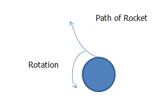

Is this closer?
