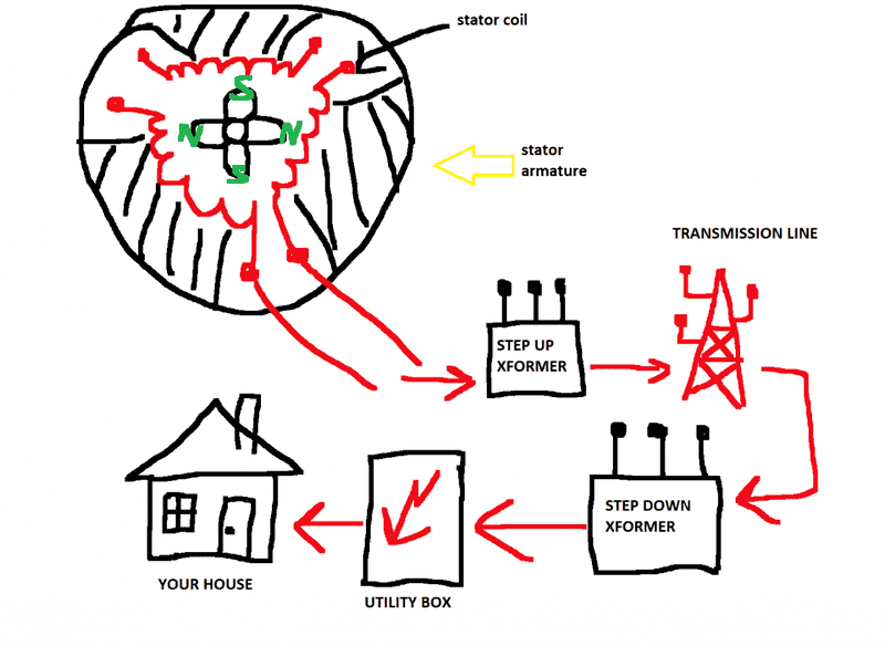

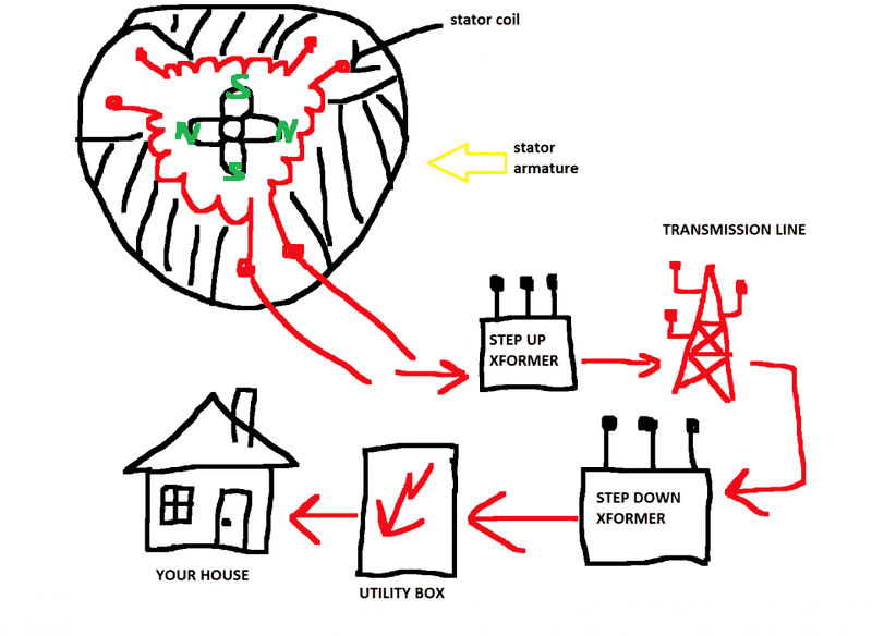

Some say that AC should form a closed loop circuit for electricity utilization but is there really an loop from the Power station(hot wire) to the Ground(neutral) and then from Ground to power station so that it forms a loop?
Yes there is such a loop.
But it doesn't usually include "ground"
Plus,
It's not a single loop but a series of closed loops like the links of a chain
each loop connecting two of the transformers in the long distribution chain between the power station and your house.
So the return current from your house doesn't go all the way back to the power plant, only to the transformer on the pole by your house.
That transformer recirculates its high side return current back to the transformer in a switchyard that feeds your neighborhood,
and so on all the way to a power plant somewhere.
Each transformer is the junction of two links.
maybe i should have drawn them linked ?
Naaahh, you get the idea, current doesn't cross the transformer core only energy does...
If there's any current flowing through "Ground" in one of those many links
it's because there's an unbalance, ie currents in the opposite sides of the link aren't equal.
When your studies take you to three phase you'll learn that the links are not simple two wire loops but have three main wires, plus another lesser wire called "Neutral" which is usually earthed by grounding rods.
I hope this oversimplification helps plant the concept. Really it's just Kirchoff.
