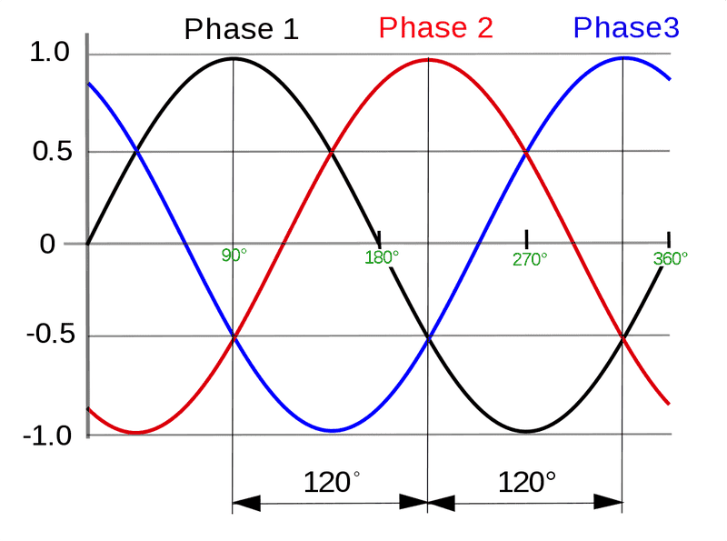

But power transmission is three phase, not single phase like in your house. In three phase circuits, no return line is needed.
How is that trick done? Look at the plot below. At every point in time, the three phases add up to zero, so there is nothing to return. Pretty clever trick don't you think? The advantage of no return is why they use three phase.
Graph of three sinusoidal waves against angle from 0 to 360 degrees, labelled Phase 1 (black), Phase 2 (red) and Phase3 (blue), each offset by 120 degrees, with values from -1.0 to 1.0 on the vertical axis.

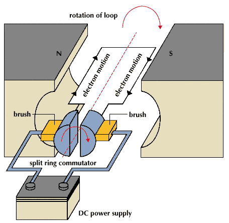

I tried asking many sites of how a commutator reverses the direction of current but everyone said "it's hard to explain using words".Could you help me with this.
so the black wire and neutral wire would be hooked up to the commutator as left side and right side. (it's a disk with two isolated sides). As the coil rotates in the generator it makes positive voltage for one half the cycle and negative voltage for the other half (in the coil). when the coil starts to make negative voltage the contacts (from the coil to commutator) on the disk switch sides so that the connection on the circuit is reversed and you have DC on the circuit side.

Could you tell how the disk switch sides?That's where I'm stuck.
there are brushes on the coil which drag along the disk. They rotate with the coil, and are set up so that when the voltage is switching the brushes are going to the other side of the disk (left to right or right to left). Like running your two fingers around the rim of a glass (on opposite sides), where two sides are isolated

Oh sorry but I still couldn't get it.Is there any animation that shows commutator reversing the direction of current?
I couldn't find an animation but this picture shows the split disk and direction of rotation, with the connections... maybe it will help? you can imagine the disk and wire rotating, you see the brushes touch different sides as it rotates
Diagram of a DC motor showing a rectangular wire loop between N and S magnet poles, with a split ring commutator, two brushes, a DC power supply, and arrows marking electron motion and rotation of the loop.
