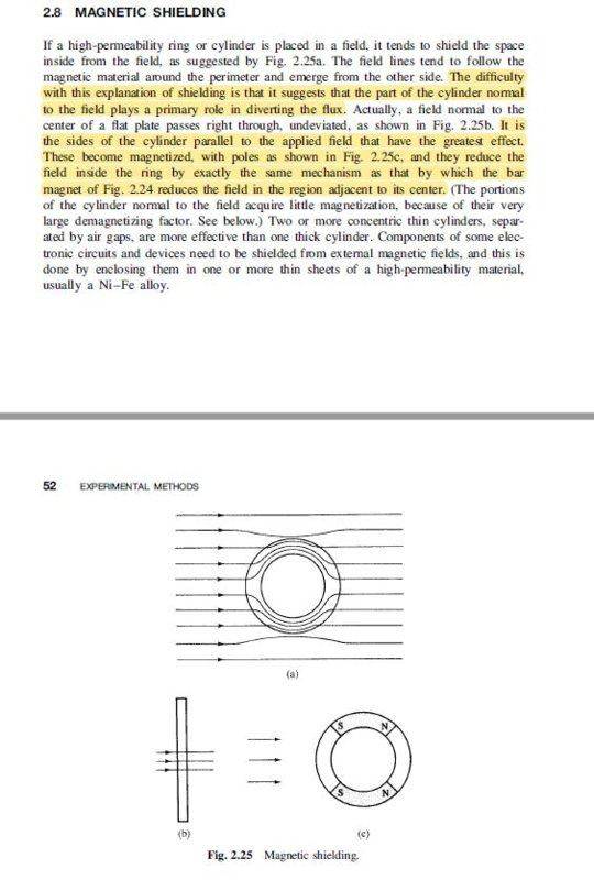

Hi.
This picture shows an iron ring shielding a static magnetic field:
Does this really work, and why? I know that a conductor can shield an electric field (Faraday cage) and a changing magnetic field (Lenz's law), but why would it shield a static field? Especially since iron is a ferromagnet.
"It can" is a better answer than "it will". The field lines go through the iron and not the air.
greypilgrim said:
Hi.
The iron ring will provide a lower-reluctance path to the magnetic flux so areas to the right of the ring will have a much lower B field than were the ring absent.
Magnetic circuits are analogous to electric ones: substitute mmf for emf, reluctance for resistance, flux for current, permeability for resistivity, etc. The main difference is that magnetic flux is not nearly so well confined to its "conductor" (a low-reluctance path) as current is to wire.
You can understand this phenomenon from the perspective of magnetic reluctance. But I think the description from the book is more accurate.
