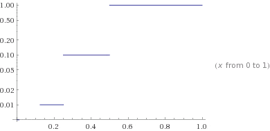

Do you know what a graph of f(x) looks like?

Look at the function as I described it earlier. The function is defined for all x on [0, 1] . The graph of the function is a set of horizontal line segments. When considering the area under the function, that area can made up (in an exact manner) as a set of rectangles with no gap between any of those rectangles.
Give an instance of any place on the interval [0, 1] where you need to use a triangle to find the area.
   https://www.physicsforums.com/attachment.php?attachmentid=54809&stc=1&d=1358440853
The above is a log graph and a standard graph of your function.
(From WolframAlpha)
