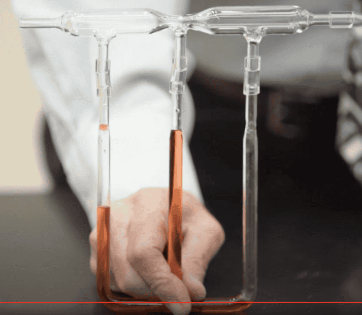

TL;DR Summary: Classical Physics states that a gas will only flow from a region of high to one of low pressure and, like water, won't run uphill. This demo of Bernoulli's principle appears to show gas flowing into in the opposite sense, from low to high from the centre constriction to the second wide tube section. What's happening?
Here's a grab at 1:50 from the Bernoulli's Principle Demo: Venturi Tube video
It appears to show the air flowing from the viewer's right to left where the pressure in the third manometer appears to be higher than in the middle one.
Is there some complexity from the manometers being interconnected?
Water won't flow uphill. A gas will only flow from high to low pressure.
How can this be a correct interpretation?
This is all news to me. I would have thought that the pressures would be highest on our right, lower in the middle, and lowest our left. But the video seems to be backed up by several authorities. It must be that, at least in the sense of the manometers, the air is flowing from lower to higher pressure when it passes from the middle part to the part on our left. I don't think that they are all paid up on this yet, since, if I was going to guess it, then it is very probably possible to get some manometers to line up the other way, from higher to lower to lowest, left to right, somehow, notwithstanding some much smaller constriction in the set up?
Which is perfectly fine, as long as it slows down, as explained in post #5 already:
boneh3ad said:
Gas has inertia like any mass. Pressure gradient provides a force, so moving from low to high pressure will slow it down and moving from high to low will speed it up.
This is just Newtons 2nd Law: The net force gives you the direction of acceleration, not the direction of velocity.

Sailor Al said:
I was referring not to the drop of water at the top of the third manometer, but the level of the top of the water column which is indeed lower than in the second column. Isn't the pressure indicated in the second manometer therefore lower than in the third one? Isn't the air moving from a lower pressure in the second one to a higher one in the third one. I don't understand how that can happen.
