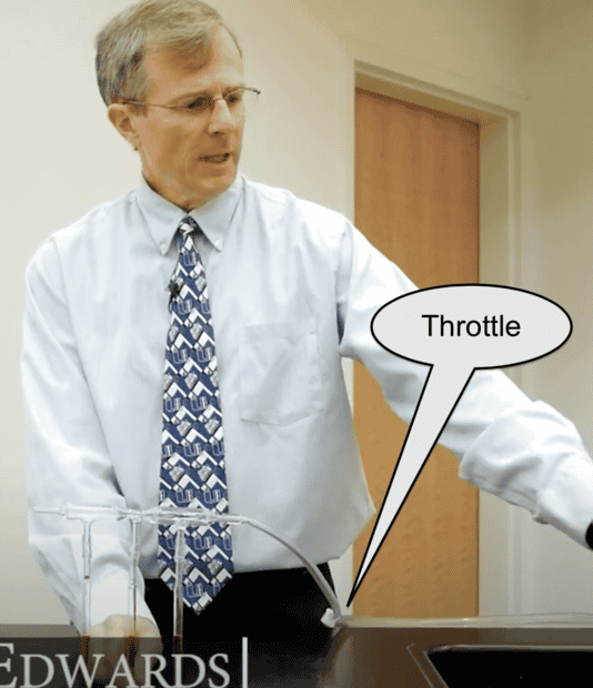

There is a throttle on the air supply.
Pure speculation, but I suspect, for the video, he adjusted that to get the water level at tube A to zero. (I bet that took a bit of fiddling, and water squirting through the tubes which would explain the bead of water at the top of tube C!)
Multiple Choice: From the picture, what's the effective area of the "pinched tube"? If the tube has area ##A##, is it
a) 80% ##A##,
b)50% ##A##,
c) 0%##A##

I think I specified that in the original question. I suggested the diameter of A was 1.6 cm and B, 0.5 cm, so the cross-section area of A is 2.01 cm2 and of B is 0.196 cm2. So B is ~10% of A.
  • #130
I'm talking about the throttle you are pointing out. If the feed tube has area ##A_{tube}##, what is the area of the "pinched" section.
Also, you have not answered #125.

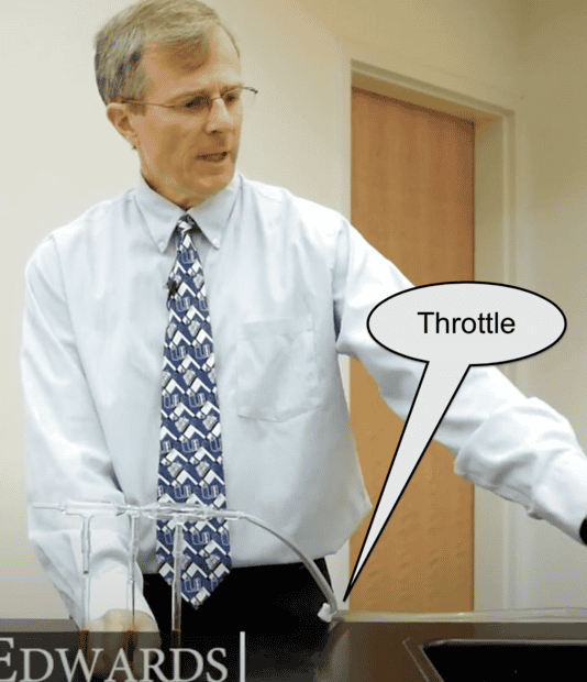

I'm talking about the throttle you are point out.
I'm sorry, there's no way of determining that. And even if we did know that, we still don't know the pressure behind that nozzle/diffuser. It's just adding another set of nozzles and diffusers to the problem.
It's a variation on my question 1) in #111.
I only pointed out the throttle to allay your concerns about the small size of the apparent pressures in the tube that prompted my question in #118: "What's absurd about 4cm pressure difference between A and C?"

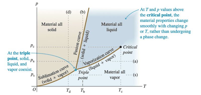

This (the manometer setup in the experiment):
The reference pressure for the experimental setup could be literally anything. The manometers are coupled.
It is not the same as having three independent manometers as you are treating the problem (like show below):
Where the reference pressures for the setup is atmospheric (at the open top of each manometer).
  • #146
Not quite!
As long as the experiment was run when the environment was in the region of the phase diagram :
where water was liquid and air was a gas, the numbers would be the same. 0, 9.5, 5.5 cm.
Even if the environment was other than air: Argon, Nitrogen., Hydrogen, Helium...
I am sticking with the problem, I think there are more insights on the way!

What does the phase diagram have to do with this simple issue I'm trying to point out that your "analysis" is completely bungled. The manometers are coupled! They are not independent of each other as I clearly illustrated in #145! Your response was "gotcha" it cant be "anything" because of phase changes, when it should have been..."Oh yeah, I see what you mean"... My patience is now worn completely through the paper and is beginning to dig my own grave... Good by!

The point is that the experiment is what it is. The manometers ARE linked, and we only have those numbers to work with.
