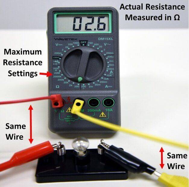

Does Ohm's Law work for Light Bulbs? I did a simple experiment where it doesn't seem to.
Does Ohm’s Law, V = IR work for light bulbs? It appears not to from my simple experiment below.
In the figure below, I measured the resistance of a lightbulb and found that resistance to be 2.6 ohms.
However, when I connect this lightbulb into the circuit where I measure the voltage across the lightbulb and the current through the lightbulb simultaneously, the entire simple circuit sourced by a power supply, then I get a derived resistance of 18 ohms.
I say derived because the voltage I measure is 3 Volts across the lightbulb and the current through the lightbulb is 165 mA. By Ohm’s law, 3 Volts divided by 165 mA is equal to 18 ohms. If the resistance of the lightbulb with current flowing through it is indeed 18 ohms, this certainly does not match the resistance of 2.6 Ohms measured directly by the resistance meter of the multimeter. From such an experiment, I would conclude the Ohm’s law does not work for light bulb.
Can anyone confirm that Ohm’s law does not work for a light bulb?
Obviously, the lightbulb heats up, and that heat could change the resistance dramatically when the lightbulb has current flowing through it versus when there is no current flowing; this is the only explanation I can think of off the top of my head of why Ohm’s law does not work for a lightbulb.
I actually measured the resistance of all the wires, the ammeter, etc and their total resistances still came to around 3 ohms; thus, the high resistance of 18 Ohms measured by the lightbulb when On cannot be attributed to the resistances of other components in the circuit.

Ohm's law does not work for a light bulb. It does behave like a resistor, but the value of its resistance is a strong function of the filament temperature. Its resistance increases dramatically as it heats up.

That's not exactly true. At every instant of time, Ohms Law DOES apply --- it's just that a light bulb is not a simple resistor so you can't measure current at one time and voltage at another and get a meaningful value for resistance (until/unless it has reached steady state).

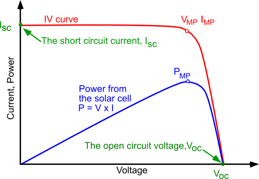

I like to remind myself with a plot of the voltage-current characteristic of a solar PV cell. The slope of that curve at any point ##\frac{\partial V}{\partial I}## is the resistance, but the slope is hardly constant, nor is the intercept (0,0). However, there are regions where the curve approximates a straight line (constant resistance), so that the Thevanin's equivalent resistance would be constant.

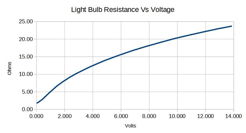

This is basically how I present resistance and Ohms law in my class
1) Resistance is defined as the ratio of voltage drop V and current I
2) for certain electrical components, there is a linear relationship between V and I, at least for a range of V and I. Such components are called "Ohmic". Then I show this for a resistor. The linear relation is "perfect" and we assign a resistance for the entire resistor
3) Then I show voltage and current for a light bulb, at first the relation is linear (at least to naked eye) but the more the voltage is increased, the current is no longer following a linear relationship. We call the light bulb "non-ohmic". We can still talk about resistance of the light bulb according to Ohms law, but we have to do that for a certain voltage.
4) Back to the resistor, I crank up the voltage so that the resistor gets really hot (you can smell a little burnt don't you) and the linear relationship is "destroyed"
