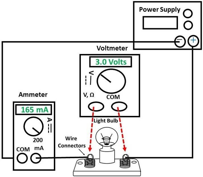

  • #36
Albertgauss said:
I’m not intending to “disprove” Ohm’s Law. From the experience of this post that I didn’t know beforehand, I will think better to reword phrases like “Ohm’s Law doesn’t work for...”
Ohm's Law works just fine. It would even work for a filament lamp if you could circulate the envelope with distilled water and kept the temperature constant, even when the bulb is dissipating its 100W - or whatever. It would work because Tungsten is a metal. (It would not glow much at 300K, though)

Ohm's Law correctly describes the relation between voltage, current, and resistance at all voltages. The resistance is different at each different voltage, but that does not invalidate Ohm's Law. It just means that the resistance is a function of voltage, or more correctly, the filament temperature.

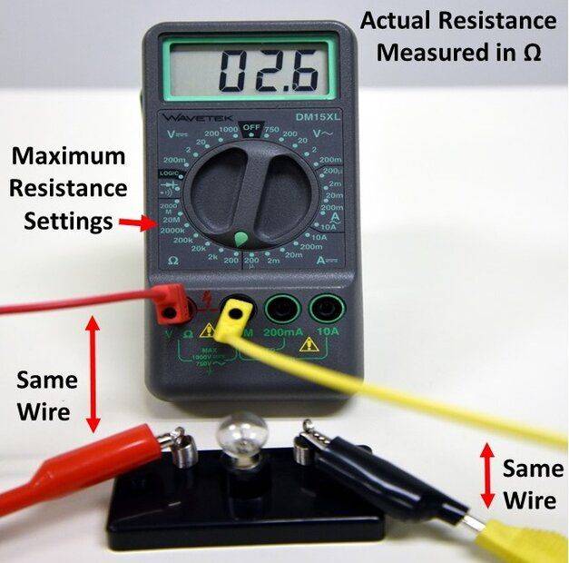

Try measuring resistance at different temperatures.

Summary: Does Ohm's Law work for Light Bulbs? I did a simple experiment where it doesn't seem to.
Does Ohm’s Law, V = IR work for light bulbs? It appears not to from my simple experiment below.
In the figure below, I measured the resistance of a lightbulb and found that resistance to be 2.6 ohms.
However, when I connect this lightbulb into the circuit where I measure the voltage across the lightbulb and the current through the lightbulb simultaneously, the entire simple circuit sourced by a power supply, then I get a derived resistance of 18 ohms.
I say derived because the voltage I measure is 3 Volts across the lightbulb and the current through the lightbulb is 165 mA. By Ohm’s law, 3 Volts divided by 165 mA is equal to 18 ohms. If the resistance of the lightbulb with current flowing through it is indeed 18 ohms, this certainly does not match the resistance of 2.6 Ohms measured directly by the resistance meter of the multimeter. From such an experiment, I would conclude the Ohm’s law does not work for light bulb.
Can anyone confirm that Ohm’s law does not work for a light bulb?
Obviously, the lightbulb heats up, and that heat could change the resistance dramatically when the lightbulb has current flowing through it versus when there is no current flowing; this is the only explanation I can think of off the top of my head of why Ohm’s law does not work for a lightbulb.
I actually measured the resistance of all the wires, the ammeter, etc and their total resistances still came to around 3 ohms; thus, the high resistance of 18 Ohms measured by the lightbulb when On cannot be attributed to the resistances of other components in the circuit.
