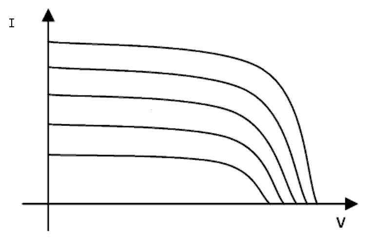

Real-Life Example, A Solar Panel
A solar panel is a real-life device.  Below, we see a family of curves showing the Voltage V versus current I relationship of a solar panel.  Each curve represents a different value of solar intensity.  As you can see, the curves range from nearly an ideal voltage source (vertical) to a nearly ideal current source (horizontal), to everything in between.
solar1

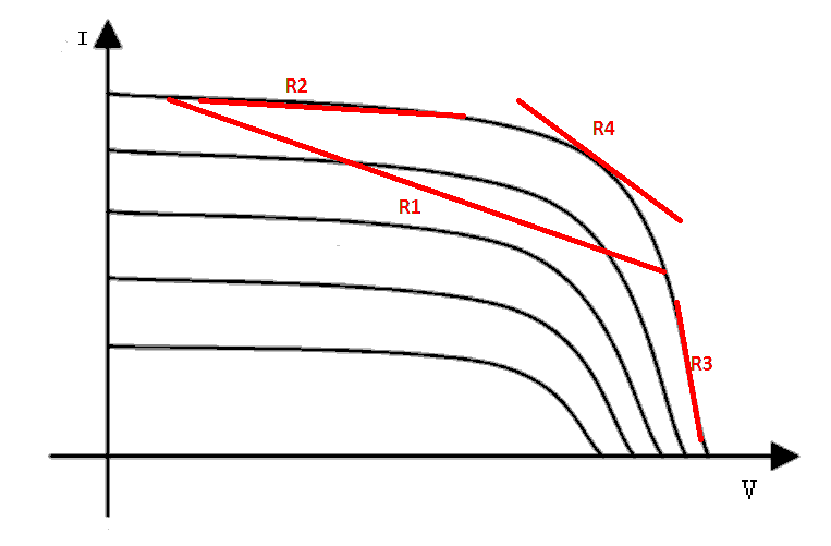

We can draw straight line segments to define the average resistance over a particular range, like R1, R2 or R3.  As you can see, the panel ranges from nearly an ideal voltage source to a nearly ideal current source, to everything in between.  R4 shows a resistance defined by the tangent to the curve at one particular point.  I call R4 the resistance linearized about a point on the curve.
solar2
We could use these resistances, plus Thevanin’s Equivalent voltage ##V_{thev}##  to model the solar panel in a circuit to be solved using Ohm’s law. (##V_{thev}##  is  the place where the straight line intercepts the ##V## axis or where ##I=0##).

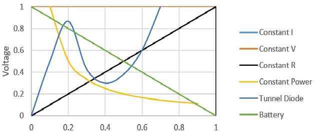

Arbitrary Numbers of Arbitrary Electric Devices
When we go beyond a simple resistor made of some material with a linear V-I relationship, we find that very many real-world devices are non-linear.  For example, the constant power device (yellow) and the tunnel diode device (blue) curves are seen below.   There are no physical constraints on the shape of a V-I relationship other than that both V and I must be finite.  Even a multi-valued curve that loops back on itself violates no physical law.
VI
Students in elementary circuits courses often learn only about the constant R (i.e. the resistor) element, plus L and C.  Other kinds of nonlinear circuit devices may not even be mentioned.
At first glance, you might say that Ohm’s law doesn’t apply to nonlinear devices, but that’s not true. Suppose we had a circuit containing a solar panel, a constant power, and a tunnel diode.  A student using paper and pencil could not be asked to solve such a circuit, so courses that limit themselves to paper and pencil methods do not cover nonlinear elements.  But using computers, there is a relatively simple method:
  1. Guess an initial V and I point along the curve for each device.
  2. Find the linearized resistance (analogous to R4) for each device at the V and I guess point.
  3. Solve the linearized circuit using Ohm’s law, calculating new values for each V and I.
  4. Use the calculated V and I as the new guess and return to step 2.
An iteration like that is very easy to perform with a computer.  It isn’t guaranteed to succeed, but when it does succeed, after several passes through steps 2 and 3, it will calculate values for V and I that simultaneously satisfy the relationships of all linear and nonlinear elements in the circuit.    It is routine in power grid analysis to solve circuits with a million or more diverse nonlinear elements.  Thus, even when modeling devices that don’t seem to obey Ohm’s law, that we can make productive use of Ohm’s law nevertheless.  I’ll say it again using stronger words. Ohm’s law cannot be violated in real life; rather it can be adapted to nearly all real-life situations in electric circuits.
Ohm’s law is not always a complete description of electrical devices, but Ohm’s law is almost always a useful tool.   Students are advised to learn to think that way.  Physicists and engineers seek usefulness and try to leave the truth to philosophers.
