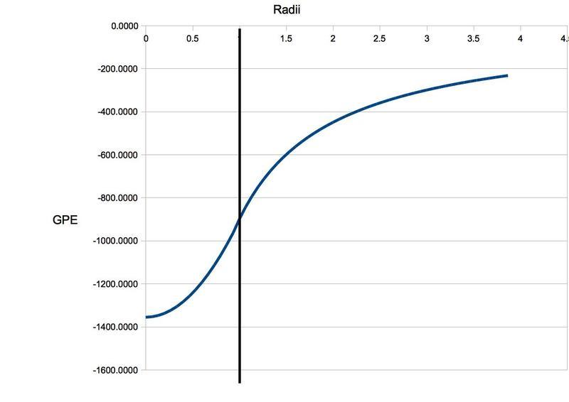

Hold on there. The Earth is not a point mass, which would exhibit the inverse law for potential. The Shell Theorem tells you that, once below the surface of a sphere, the bits 'outside' provide no potential at all. Once you get to the centre, there is zero potential: not -∞, which some of you seem to be suggesting.
As I said earlier, take the potential as the work done bringing a kg from infinity to your point of interest. Everything then falls out nicely for you and you've no need to worry.
The maximum (negative) potential and, hence, the greatest (attraction) force is, therefore, on the surface.
An equation is worth a thousand words.
To get from the centre of the Earth will take energy so you must be at a negative potential whilst at the centre.
Think of it like being in a hole - no matter what you do it takes energy to get you out. You are at a negative potential in relation to the surface.
You can certainly put yourself at zero, but the surface will always be at a higher potential - and you need to do work to get there.
Yep. Right.
It's just that the force law is linear and not 1/r2.
The extra PE is
-∫Gρr dr from r=0 to r = R
which is
-GρR2/2
The potential wrt to the shells outside you may be zero but, as soon as you start to climb, there are shells below you, which gives you the result above. But I am still having a bit of a problem with the definition of potential. Inside, it's definitely zero inside a shell but suddenly it becomes non-zero. That's the problem with intuition - you can't trust it.

There is always an arbitrary constant with respect potential energy. You can define the potential energy for a hollow spherical shell of mass such that the potential inside the shell is zero.
That is not the typical definition of gravitational potential. The canonical form has potential energy equal to zero at an infinite distance from the mass in question. With that definition, the gravitational potential energy for any mass distribution is given by
\phi(\vec r) = \int \frac{-G\rho(\vec x)}{||\vec x - \vec r||} d\vec x
In the case of a thin (infinitesimally thin) spherical shell of mass m and radius a, the gravitational potential is given by
\phi(\vec r) =<br /> \begin{cases}\frac{-G M}{r}\quad&amp;r&gt;a \\ \frac{-G M}{a}&amp;r&lt;a\end{cases}
Note that inside the shell the potential is constant but it is not zero.
Potential inside the shell is constant, not zero. What that constant is depends on your reference.

Sorry, I've read through this and I'm still a little confused.
Potential energy aside, what is the gravitational potential at the centre of the Earth (assuming constant density, and perfect spherical shape), and defining gravitational potential as the work done per unit mass moving an object from a distance of infinity to that point.
A lot of the information in this thread suggests that gravitational potential is at a maximum (a negative maximum) on the surface of the earth.
But if there is a gravitational force within the Earth's surface, this suggests to me that the potential must be greater within the Earth's surface, because the work done in getting from the surface to that point should be negative, and would be added on to the potential from getting from infinity to the surface.
In summary I'm asking what is the gravitational potential at the centre of the earth, and what is the potential slightly outside this point.
  • #40
The GPE gets more and more negative but.instead of going down to -∞ (for a point mass), it follows a parabola which levels out to a minimum at the centre.
I plotted this on a spreadsheet. Also, I was interested / surprised to see that the difference in GPE from surface to centre seems to be half the GPE at the surface (wrt ∞). The analysis gives you this factor of 1/2 when you integrate the force on the way up to the surface (you get an r2/2) yet there is no corresponding 1/2 when you integrate the force going from the surface to ∞. I am assuming uniform density of course.
The vertical scale is in arbitrary units of energy, (btw)
