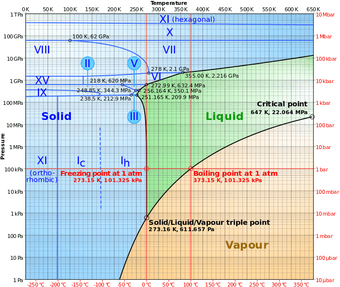

I am somewhat confused by what pressure refers to in a phase diagram? In a closed box it makes sense to me that the vapor pressure would eventually equilibriate at a pressure determined by the temperature. However, say you have an open box. It makes sense that the liquid would boil when the internal vapor pressure is equal to external pressure. However, at a lower pressure the liquid would still be evaporating. I'm basically wondering at what point would simple evaporation fall on the diagram? Since there is both liquid and gas? And what corresponding pressure would you use? Vapor + ambient pressure?
Phase diagrams show equilibrium states, they do not show processes. So "boiling" and "evaporation" do not appear on the diagram.

This is a phase diagram for water:
I assume by "equilibrium line" you are talking about the separation between the different phases of this substance.
If you boil water in a closed container, the boiling point will probably occur at a temperature slightly higher than if you were boiling water in an open container, because the pressure in the closed container will be slightly higher than ambient. This is why people use pressure cookers and our car radiators have pressure caps.
Ok, yes; moving from one state to another state is a process. Your initial wording threw me when you said "at what point would simple evaporation fall on the diagram?" (Still doesn't) But, you can and do diagram processes using that diagram (or the information in table form).
So here's how to do it: define your states and draw a line between them representing the process.
Example: If you have a bucket of water sitting on the floor of your house, in a steady evaporation, what are the two states? (phase, temp, pressure - pick values that make sense for your house).
Boiling is a special case of evaporation, so let's just do evaporation first.
The pressure refers to the environmental pressure, not the vapor pressure. The vapor pressure depends mostly on the temperature, whereas the environment pressure is orthogonal to the temperature.
They are equal along the vapor-liquid phase boundary.
Evaporation is not shown on this diagram. Evaporation depends on the relative humidity of the air. In the liquid zone of the phase diagram, there is actually an equilibrium between liquid and vapor. This equilibrium is called 100% humidity. If there is less than 100% humidity (only possible outside of equilibrium), then evaporation will take place. If more than 100% humidity, there will be dew or rain.
The equilibrium is where the vapor pressure of the water is balanced by the partial pressure in the air.

This makes sense to me logically. However, on the phase diagram for water, take the point 1 ATM and 100 C. It lies on the equilibrium line. So if I have a bucket of water exposed to 1 ATM of ambient air (no water), the system obviously won't be under equilibrium because the air isn't a 100% humidity. Yet the system still lies on the line of equilibrium?
Because as you said, "The pressure refers to the environmental pressure, not vapor pressure"
I'm not sure that last bit was worded right: it is vapor pressure for the vapor. For the other phases, the environment provides the pressure.
So that means no, your bucket in air at 100C is not a single point, it is two separate points. The water vapor in the air is somewhere different from the water in the bucket.

You have a bucket of water at a pressure 1 atmosphere AND a temperature of 100 °C. The water in the bucket is going to be boiling, regardless of what the relative humidity is.
The atmosphere is able to have different amounts of water vapor suspended in it, but this does not alter what happens to a large amount of the substance which is relatively isolated from the atmosphere.

Okay sure. However that is still a point on the equilibrium line. So what exactly does that mean if it's boiling.
I essentially understand several things and correct me if I'm wrong:
1. Water will evaporate until it reaches the saturated vapor pressure given by the specific temperature. (This is independent of any external pressure, as far as I understand)
2. If the vapor pressure within the water (which would be the vapor pressure in the air, if it was able to reach equilibrium) exceeds the external pressure the water will boil at the boiling point as additional heat is added.
So basically my question is, what exactly does a phase diagram apply to? An open system, closed system, the phases separately, together? It seems like the equilibrium line isn't an actual point of equilibrium since the system reaches equilibrium when the vapor pressure reaches a certain level, and on the actual equilibrium line the water is boiling.
Ehhh haha
At the boiling point, the water has enough vapor pressure to spawn bubbles of pure water vapor anywhere in the liquid where there is a nucleation site. Raising the pressure raises the boiling point because it requires a higher vapor pressure (which increases with temperature) to push the water out of the way to spawn a bubble. Below the boiling point, but above the dew point, water only evaporates at the surface. The water doesn't have enough vapor pressure to lift the water out of the way form a vapor bubble.
The difference between dew point and boiling point exists because air a mixture of many gases. Things will become even more complicated if your liquid is also a mixture.
1. (Edit: actually, your statement looks ok). Saturated vapor pressure depends on the external pressure. Relative humidity of 80% at 30 degrees C has a lot more absolute water content than relative humidity of 80% at 20 degrees C.
2. Yes. I would replace the term vapor pressure with partial pressure in the air.

The phase diagram for any substance is obtained by testing samples of the pure article under a variety of combinations of pressure and temperature, primarily, but not exclusively, to establish the boundaries of the different phases of that substance. Using the phase diagram in an actual environment will be subject to certain limitations and cautions about its applicability.

States. I'm wondering if the problem is that you don't understand what a "state" is. In thermodynamics, a "state" is a list of properties that describe a substance. You can grab as much or as little of that substance as you want and as long as that's all at the same conditions, it is all at the same state. It doesn't matter if the system is open or closed: but phase is a property, so clearly different phases are at different states.
What equilibrium? If the water is boiling, it is changing state: it is not at equilibrium.
You haven't taken my advice from earlier and defined the properties at the states. It will become much, much clearer if you do that because then you will find that the states you are suggesting are at equilibrium with each other are actually very far apart. In other words: the states you are describing do not both fall on that line.

Sure. You've already started describing one: a bucket of water at 100C and atmospheric pressure. That's a state. The system is open and the water evaporates into the room. That's another state. Define the conditions of that state (pressure, temperature) and see where it would be plotted on the phase diagram.
And also, why is that line called an equilibrium line then?
The equilibrium line is an equilibrium line. You're just not describing/using it properly yet.

Put a lid on the bucket and pump out the air. It will then be a water/vapor mixture at 100C and atmospheric pressure.

It will be somewhere on the liquid/vapor boundary, but would be colder than 100C, and lower than atmospheric pressure.
For the pure chemical case (e.g. water, with no air), it might help to see the 3D phase diagram, as shown here:
http://hyperphysics.phy-astr.gsu.edu/hbase/thermo/pvtexp.html#c1
We see that there is a 2D surface which you can regard as pressure as a function of temperature and volume. The state of the chemical is given by a point sitting somewhere along this surface. The surface is broken up into several faces which correspond to different phases. The formulae for the faces are called equations of state. (For example, the ideal gas law PV=nRT is an equation of state which is approximately valid in the "gas" part of the diagram above the critical temperature.)
If you put water in a closed container, this will constrain the density and volume, and the state will lie somewhere along the 2D cross section which looks like a traditional P vs T phase diagram. If the volume is large, that means your density is low, and you have only gas. If we half fill a bucket of water and pump out the remaining air, we will end up somewhere on the "liquid and vapor" face. That means there is an equilibrium between the liquid water, and the water vapor in the container. The pressure will be the vapor pressure of the chemical at whatever temperature it ends up at.
Therefore, it will be at the boiling "point", but as we can see on the 3D diagram, boiling is possible over a whole face (the liquid and vapor face), not a point.

So I've got the basic idea but I've kind of come up with a contradiction. Say I have a closed box, and the water has reached equilibrium with its vapor pressure at 100C, with a vapor pressure of 1 ATM. Now I pump in some external gas, which will increase the total pressure inside the box but the vapor pressure will not change since the water is in equilibrium and adding some extra gas doesn't change anything. I also assume adding this gas doesn't change the temperature.
Now I will plot both states on the phase diagram as you have told me, the vapor and liquid. Initially, the vapor and liquid both lied on the same point on the equilibrium line. However now, hasn't the pressure in both states increased by the same amount? Won't the vapor and liquid states somehow now both lie in the liquid area of the phase diagram?
The contradiction being: how can a vapor's state be located in the liquid only region of the phase diagram if it's clearly a vapor?So basically considering the scenario you mentioned earlier, without pumping out the air.
If you pump dry air back in and pressurize it while keeping it at 100C, you haven't changed the vapor's state because its pressure is still 1ATM, but you have changed the water's state by raising its pressure.
Before you pump in air, the dew point and boiling point are the same, 100C. If you pump in air, while keeping the temperature the same, then the pressure increases, so the boiling point will increase, but the dew point will stay the same. The water is at its dew point because the vapor pressure equals the partial pressure of water in the gas, so it is in equilibrium.
