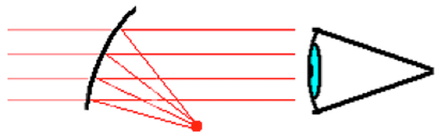

Ozen said:
reflex sight for rifles
Do you mean like a reflective "red dot" sight?
https://www.burrisoptics.com/blog/sights/how-a-red-dot-sight-works
Diagram of a concave mirror reflecting parallel red rays from the left to a single focal point at lower right, next to a sketch of a triangular eyepiece-like shape with a blue lens.

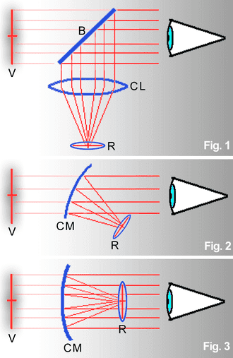

There is a good Wikipedia article about them:
https://en.wikipedia.org/wiki/Reflector_sight
Three-panel optics diagram of a reflex sight: parallel rays from a vertical source V pass a tilted semi-mirror B and curved lens CL to a reticle R; panel 2 shows a concave mirror CM with reticle R; panel 3 shows a concave mirror CM focusing to R, with an eye at right in each panel.
