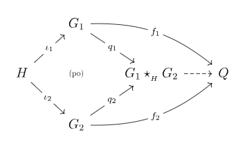

Maybe this diagram will help to see why i have problem.
In my mind the universal property of group coproduct did not need amalgamated free product
I had no H only G1,G2,Q and G1 * G2 (not over H) and the injections q1,q2 and the arrows f1 , f2
and tried to understand why the construction with words, concatenation could help to
build the dashed group homomorphism f.
Have you another universal property depending on H?
Ok, this simply means ##H=\{1\}.## The elements of ##G=G_1\ast G_2## are words over the alphabet of elements from ##G_1## and ##G_2.## Say we have ##abcxyacbza\in G## with ##a,b,c\in G_1## and ##x,y,z\in G_2.## Then we have a homomorphism ##f_1\, : \,G_1\longrightarrow Q## that maps ##a,b,c,## say onto ##\overline{a},\overline{b},\overline{c}## and the same for ##f_2\, : \,G_2\longrightarrow Q## that maps ##x,y,z## onto ##x',y',z'.## The dashed group homomorphism ##f## maps then ##abcxyacbza## onto ##f_1(a)f_1(b)f_1(c)f_2(x)f_2(y)f_1(a)f_1(c)f_1(b)f_2(z)f_1(a)= \overline{a}\overline{b}\overline{c}x'y'\overline{a}\overline{c}\overline{b}z'\overline{a}.##
