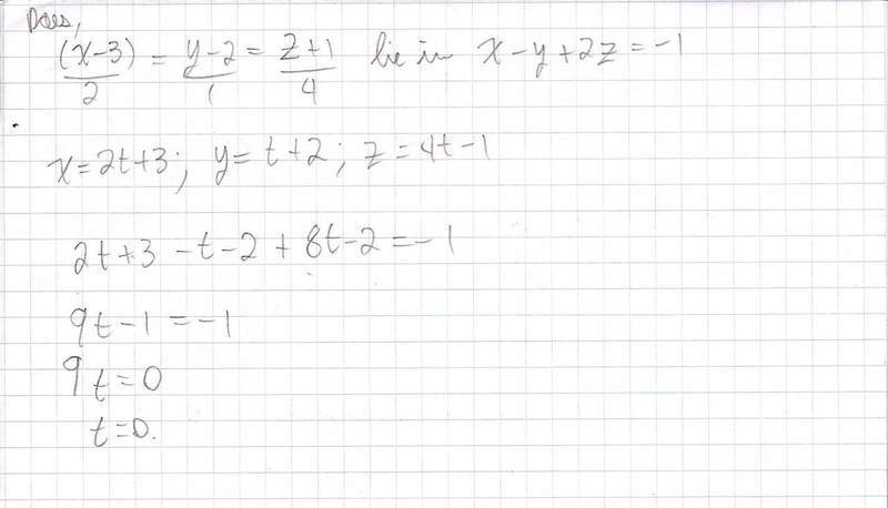

See figure for problem statement. It asks if a given line lies in a given plane.
Okay so first I translated the line into its parametric equations and then I subbed those into the equation of the plane respectively.
After simplifying you'll find that,
[tex]9t-1 = -1[/tex]
Now my solutions manual states the following,
*NOTE* There is no symbol for not-equivalent in tex, so I'm writing NE
[tex]9t -1 NE -1[/tex]
Why is this so?
Why not let t = 0, and then -1 = -1 and then all will be well in world, no?
What am I missing?
\neq works :wink:
[tex]9t -1 \neq -1[/tex]
Why is this so?
What am I missing?
Each value of [itex]t[/itex] corresponds to a single point on the line. If the entire line were to lie in the plane, the equation would have to be true for all values of [itex]t[/itex] (all points on the line), not just [itex]t=0[/itex]
