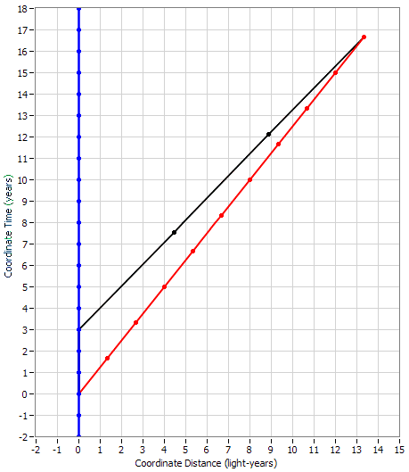

ghwellsjr said:
For example, if two atoms moving away from each other at some speed give off a frequency of light that can be observed by the other atom, they will each see the same Doppler shifted frequency of light, or a slowing of the frequency. But this is not Time Dilation. If they are moving towards each other at the same speed, they will each see a speeding up of the frequency but in both cases, the same Time Dilation is in effect.
Here is a spacetime diagram showing two of these atoms, one red and one blue, starting off separated from each other but approaching and passing at 0.8c:
Please note that this is the rest frame of the blue atom and the red atom is the one that is moving at 0.8c and so it is the one that is Time Dilated by the factor of 1.667. The dots mark off one-nanosecond increments of time for each atom.
At the bottom of the diagram, the red atom is moving toward the blue atom and during this time, the blue atom sees the frequency of the light pulses coming from the red atom Doppler shifted by a factor of 3 as you can see by the 3 thin red lines compressed into the one-nanosecond interval of time just before the red atom reaches the blue atom. Once the red atom passes the blue atom, the Doppler shift changes to a factor of 1/3 so it takes three nanoseconds of blue's time to see each one-nanosecond pulse coming from the red atom.
The first lesson to be learned here is that the blue atom cannot see the Time Dilation factor (1.667) of the red atom, it can only see the Doppler shift factors of 3 and 1/3.
Now let's look at another diagram showing what the red atom sees of the blue atom's pulses:
Note that this is the same IRF as the first diagram, the rest frame of the blue atom. However, the Doppler shift factors that the blue atom saw of the red atom's pulses are identical to the Doppler shift factors that the red atom sees of the blue atom's pulses.

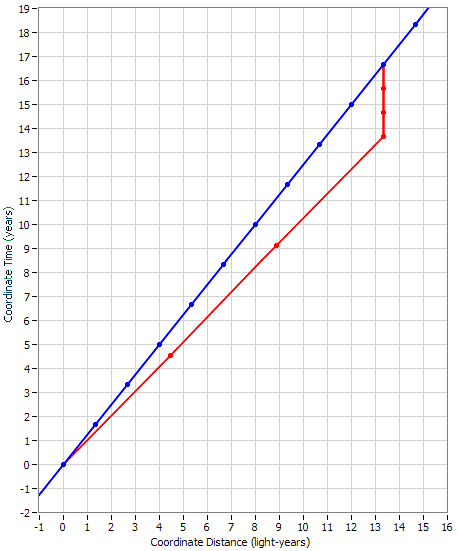

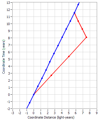

ghwellsjr said:
Time Dilation is not observable, it is the result of assigning an IRF to both atoms which will determine the speeds of both atoms and that establishes the Time Dilation of each atom, the faster it is moving the more its Time Dilation. You can make one atom at rest in one IRF which makes the second atom have all the speed so only the second atom is Time Dilated. Or you can have a different IRF in which the second atom is at rest and the first atom has all the speed making it the only one with Time Dilation. Or you can have an IRF in which both atoms are moving in opposite directions at some intermediate speed which will make them both have the same intermediate Time Dilation. But in all cases, they both see the same Doppler shift in the observed frequency of light.
As stated, we can have an IRF in which both atoms are moving in opposite directions at the same speed, in this case 0.5c:
The Time Dilation factor for both atoms is 1.1547 and I show the pulses going from each atom to the other atom. Again, they each observe the Doppler shift factor of 3 while they are approaching and 1/3 while they are departing.

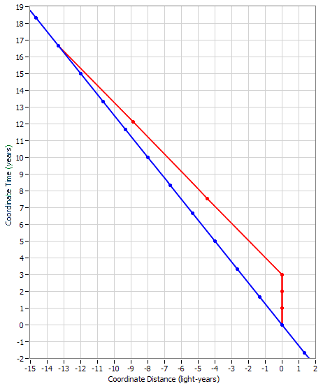

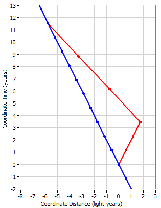

Finally, we look at the same situation but in the rest frame of the red atom:
Once again, the Doppler shift factors are the same as in the other IRF's. And as I stated, the red atom vibrates "normally" in its own rest frame.
Does this help you to understand post #4? Any questions?

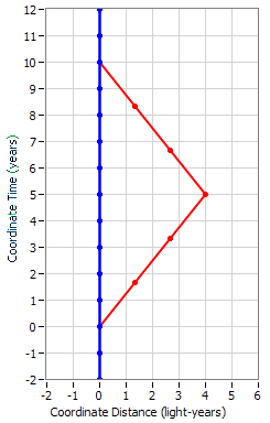

I have made some spacetime diagrams showing an astronaut traveling away from Earth and returning. The first one depicts the Earth rest frame, the one you claim has the "true" Time Dilation for the Earth and the astronaut.
Of course it is true that this diagram depicts the "true" Time Dilation of the Earth and the astronaut for the rest frame of the Earth but after this I'll show some other IRF's which also show "true" Time Dilations for the Earth and the astronaut. Note in the above diagram that the astronaut, depicted in red, travels at a speed of 0.8c so he is Time Dilated by the factor of 1.6667 which is the ratio of the accumulated Coordinate Time to the accumulated Proper Time (depicted by the dots) and that after 3 years of Proper Time for the astronaut on his way out, 5 years (3 times 1.6667) of Coordinate Time has transpired and the same for the way back. People on the Earth (depicted in blue) are at rest so they are Time Dilated by the factor of 1 and they age by 10 years (10 times 1) while the astronaut is gone. Please note how I specifically referenced the Proper Times of the astronaut and the Earth separately to the Coordinate Time of the IRF rather than to each other. That's very important to a correct understanding of Time Dilation.
Now let's transform the above IRF to one in which the Earth and the astronaut are departing away from each other at the same speed, 0.5c:
At 0.5c, the Time Dilation factor is 1.1547 so after 3 years of Proper Time for both of them, 3.5 years of Coordinate Time has transpired. That's when the astronaut fires his rocket to return home exactly how he did in the first IRF but now it gets him to a speed of 0.929c with a Time Dilation of 2.7 and it takes him 8.1 years of Coordinate Time for his 3 year of Proper Time. The astronaut's total Coordinate Time for his trip is 3.5+8.1 = 11.6 years, the same as the Coordinate Time it takes for the Earth to progress through 10 years of Proper Time at 0.5c with a Time Dilation of 1.1547. This is the first example of where the Time Dilations are "true" but different than the Earth's rest frame.
Now we'll do the IRF in which the astronaut is at rest during the first part of his journey. This puts the Earth traveling at 0.8c and experiencing the Time Dilation of 1.6667 while the astronaut has none (actually 1):
During the second part of the journey, the astronaut reaches a speed of 0.9756c and a Time Dilation factor of 4.55 and so when he gets back to earth, after 13.667 years of Coordinate Time (3 times 4.55) for a total of 16.667 years, it matches the accumulated Coordinate Time for the Earth (10 times 1.6667), another "true" example of Time Dilations.
Let's do another one, the IRF in which the Earth and the astronaut approach each other at the same speed:
This one is similar to the second one in this post, so I'll let you out the details.
Finally, the IRF in which the astronaut is at rest while returning:
This one is similar to the third one in this post so I won't go into the details.

I'd like to further disabuse you of the notion that the astronaut is the one "actually" moving because he is the one who fired a rocket and that automatically guarantees that he will be the younger one when they meet up together later on.
Let's consider an astronaut (red) leaving Earth (blue) at 0.8c but some time later, another astronaut (black) leaves Earth at a greater speed, 0.9756c to eventually catch up to the red astronaut:
In this case, it's the black astronaut that ends up younger when they meet up together.
The oft repeated "rule of thumb" that it's the twin who accelerated that ends up younger leads to misunderstanding because it leads people to believe that it's acceleration that is important in resolving twin-type scenarios even if is does work in some cases (those where only one twin accelerates). It's better to understand that Time Dilation, like speed, is frame dependent and that if you add up accumulated time for each segment of each twin's progress, you always get the correct answer.
