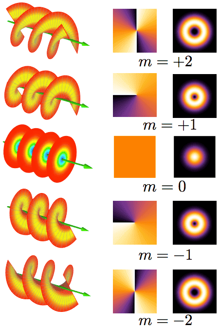

In Optics by Hecht, he say the trajectory of phase of EM wave of twisted light is helix.
An exact quote would be helpful.
It sounds like he is speaking of a circularly polarized light beam and is depicting the direction and magnitude of the electric or magnetic field vectors at each point on the beam as if they were physical displacements of the beam.
As @Drakkith points out, those lateral vectors are not displacements (e.g. in centimeters) but are field strengths (e.g. in volts/meter).
Trajectory of phase is not the propagation trajectory. The propagation direction is the straight green axis below.
From:
https://en.wikipedia.org/wiki/Orbital_angular_momentum_of_light

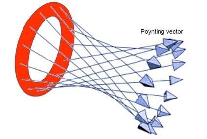

The phase velocity is greater c if propagation velocity is c?
No, actually you get a local modification of the Poynting vector. The propagation velocity along the green axis will be slightly less than c because the local Poynting vector is slightly tilted away from the green axis at every point. See the following image:
This image was shamelessly stolen from the following talk slides by Miles Padgett: https://www.gla.ac.uk/media/Media_263851_smxx.pdf
And just for the record as people often confuse that: Twisted light is not circularly polarized light, but light with a spatially varying phase front, usually a helical gradient of multiples of 2 pi.
