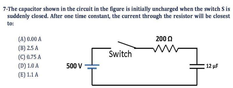

i tried to ignore the capacitor and i got 2.5 amp bec i don't know how to use capacitor or its uses

http://en.wikipedia.org/wiki/Time_constant
After one time constant the capacitor will be charged to about 0.632 * 500V.
Now you just need to calculate the voltage that drops over the resistor and divide that by 200 Ohm.

do you mean that the final voltage will be 500-316=184 and current will be 0.92 amp or i have to do something else thanks for your help dr i really appreciate it but my friend told me that the resulting voltage will be opposite in direction to that of battery can you explain how the capacitor work thx.
