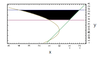

i did draw the region and rotate
but how can i do the integration?
i don't know how to deal with the inner integration now...

Find the four relevant coordinates where the curves intersect (these are the four vertices of your black region). Then, break up the integration into three pieces (from the first point to the second, the second to the third and the third to the fourth). In each section determine what are the upper and lower limits of the black region. (for example, in the first region, you will integrate from the parabola to the upper straight line).
The domain you should get by exchanging the double integral is ## {\cal D } = \{ -2 \le y \le 4, \max (1,-y, \sqrt{ \max( 0,y) } ) \le x \le 2 \} ##.
Have fun for the computations :-)
