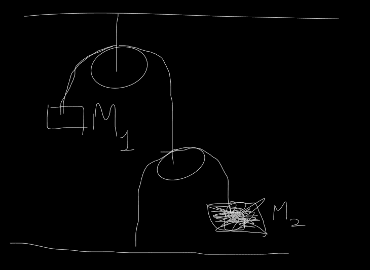

The diagram of the problem is attached on the body and strings are massless. Find the acceleration of M_1
L=T-U
Euler-Lagrange equation
Setting up coordinates for the problem

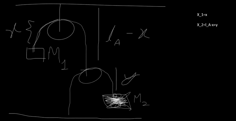

##L=\frac{1}{2}M_1 \dot{x}^2+\frac{1}{2}M_2(\dot y-\dot x)^2+M_1gx+M_2g(l_a-x+y)##
After using Euler Lagrange for x component and y component separate and substitute one to another then I get that ##\ddot{x}=\frac{M_1-2M_2}{M_1}g##
whereas on the solution they use Newtonian method and get that ##\ddot{x}=\frac{2M_2-M_1}{4M_2+M_1}##
And I thought my method of solving the question was wrong so I tried applying M_3=0 kg on [the solution](https://youtu.be/HbmN5Xb6dYg?t=566). I still can't get the answer the book wrote.
I was trying to write constraint another way...
##2x=l_A##
##l_A-x+2y=0##
for first and second rope respectively. substituted l_A and got x=-2y.. I end up with ##\ddot{x}=\frac{2M_1-M_2}{8M_1+2M_2}##. too close. Am I applying constraint correctly?

What constraint did you use for the Newtonian approach? You should use the same for the Lagrangian approach too, you just can't pick different constraint in order to make the answers match.
I think the second kinetic energy term in your lagrangian is wrong, according to my opinion it should be ##\frac{1}{2}M_2(\dot x+\dot y)^2##
But you haven't tell us exactly how you measure ##y##. Do you measure y relative to the position of the second pulley (the one that the body M_2 hangs from)?

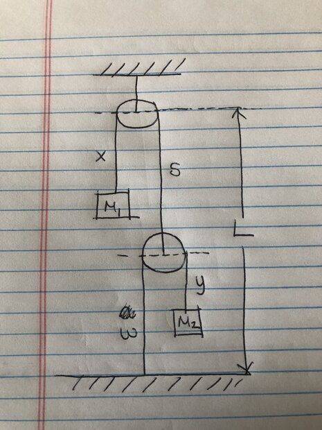

I would place the datum at the center of the pulley that holds ##M_1##.
Call the length of rope on the left ##x## as you have done, and on the right ##s##.
Then ##\dot{s} = -\dot{x}##
The kinetic energy for block ##M_2## I think is given by ## \frac{1}{2}M_2 \left( \dot s + \dot y \right)^2 = \frac{1}{2}M_2 \left( \dot y - \dot x \right)^2 ##
Then redefine all of your potential energies in from that datum
Edit:
Wait, I see that is what you have done! So I’m not sure. Should your potentials be negative?
I feel like I’m probably wrong and what @Delta2 said is correct for the kinetic energy of block 2. One seems to have ## 4 \dot x \dot y ## more kinetic energy than the other, and without using Newton’s second to confirm I’m not sure. I’m tapping out!
took first time derivative of x_2 (the equation is on first picture I attached)
Yes ok I see now.

How do you get the constraints from this datum setup? I get the following equations:
$$ x + s = c \implies \dot x = - \dot s$$
$$ w + y = k \implies \dot w = - \dot y$$
And
$$ s + w = L \implies \dot s = -\dot w$$
So what am I missing or messing up?

i suspect that at some point you have become confused between the ##y## in there and in your post #1 diagrams and the ##x_2## in post #9. In their relationships to ##x## and ##x_1,## one has a factor 2, the other does not.
I managed to solve it via Lagrangian method , using as Lagrangian $$L=\frac{1}{2}M_1\dot x^2+\frac{1}{2}M_2\dot y^2-M_1gx-M_2gy$$ and the constraint $$y=c-2x\Rightarrow \dot y=-2\dot x$$ where ##c## "proper" constant...
PS. I took ##x## and ##y## as ##x_1## and ##x_2## respectively in figure of post #9, so ##y## is defined differently which allows our Lagrangian terms to have a simple form.
