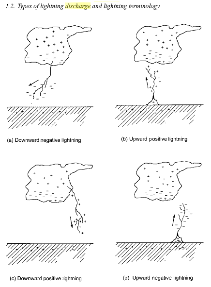

In which direction do current flow during lightning? If it is from cloud to earth, which charge gets accumulated in below part of the cloud?

You know current will flow only when the path is complete and closed. In this case, that doesn't happen. Lightning dies after some time? Its not a complete or closed path. How can you tell that charges are flowing or current is flowing?

why would you say that ? of course the path is completed and massive amounts of current flows in those brief milliseconds :)
The path is between cloud and cloud or cloud and ground between regions of excessive positive and of excessive negative charges ... the flow of current balances that out
how can you tell ? you can see and hear the effects of the of the current flowing.
the brigh glow of the ionised air, the crash of the thunder, the buildings, trees electronics etc that get damaged/destroyed because of the huge current flow

I m asking, where can you see a closed path here? We know, current will flow in a closed path only. It will reach the the ground, but where is the closed path? Also, if there is negative charge below the clouds, negative charge will flow from cloud to ground, which makes current flowing from ground to clouds. What we see is lighting striking from cloud to earth. Will lightning show the direction of current or charge? Also, there are few lightnings in those videos striking from Earth towards clouds. What can be the current flow direction in those cases?
the closed path is the ioniosed air channel between the cloud and the ground
it is probably difficult to tell in which direction the current flow is as it depends on the type of discharge because we wouldn't know what the polarity of the leader is from the ground see image ...

The wiki link originally given by Naty1 gives you an answer
snippet from Wiki...
As the field increases, the positive streamer may evolve into a hotter, higher current leader which eventually connects to the descending stepped leader from the cloud. It is also possible for many streamers to develop from many different objects simultaneously, with only one connecting with the leader and forming the main discharge path. Photographs have been taken on which non-connected streamers are clearly visible.[35]
Once a channel of ionized air is established between the cloud and ground this becomes a path of least resistance and allows for a much greater current to propagate from the Earth back up the leader into the cloud. This is the return stroke and it is the most luminous and noticeable part of the lightning discharge
so its tells you that the main discharge is in the return stroke from the positively charged area to the negatively charged area
which could be either cloud to ground or ground to cloud depending on how the charges are distributed as in the diagrams above
