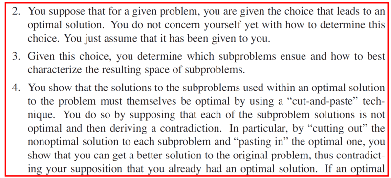

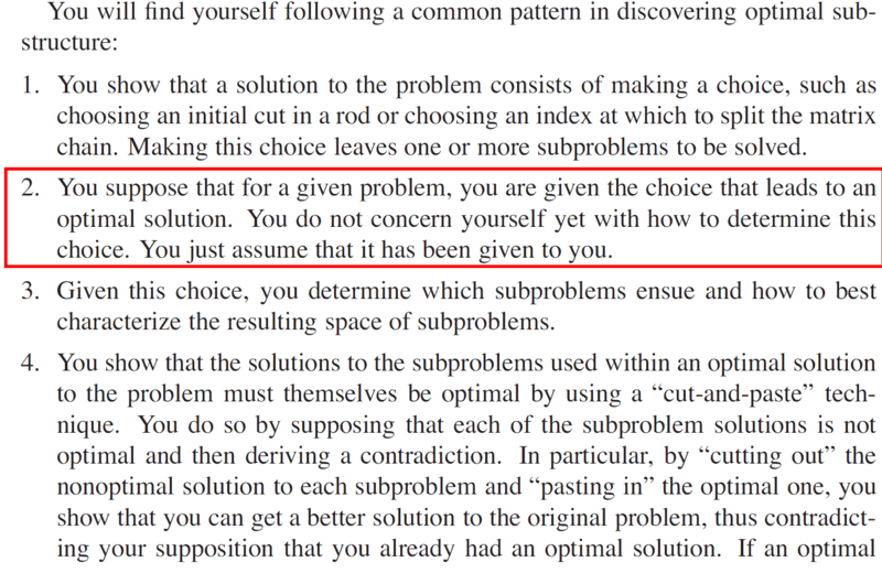

But before I went to come up with a recursive relation, I wanted to find if the problem possesses an optimal substructure, and I was following these steps as written at CLRS book:

Now, going back to proving steps 2+3+4 in the "Sherlock and Cost" problem, I have no idea what to do, I started with:
" Suppose that in order to find the array ## \hat{ A} ## s.t. ## S_{ \hat{ A} } ## is ##S_{ \hat{ A} } = \sum_{i = 1}({ \hat{ A} }_j[ i] - { \hat{ A} }_j[ i + 1])## is maximal ... [ stuff to be added ] "
but I have no idea how to continue, how would you proceed to formally proving steps 2+3+4 ( which is proving an optimal substructure exists for the problem )?

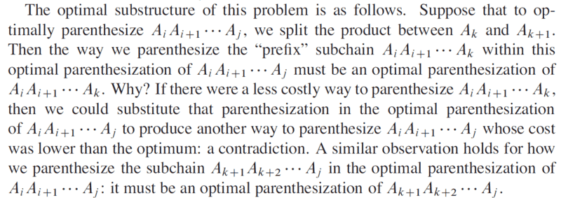

Note: Here's an example of how the existence of an optimal substructure is proved for the matrix parenthization problem ( from CLRS chapter 15.2 ) -

I don't quite understand the approach with showing ## n \leq l+1 < n ##. The logic doesn't quite make sense to me. But I think that the thing you're trying to prove isn't true anyways.
In particular, it isn't true that if ##A_{0:n}## is an optimal solution to the problem of size ##n##, then ##A_{0:n-1}## is an optimal solution to the subproblem of size ##n-1##.
Here is a counter example,
B = [1, 3, 9]
A = [1, x, 9 ] gives an optimal score which is x-1 + 9 - x = 8, for all valid x.
Meaning the choice of x doesn't matter for deriving the optimal solution, and A = [1,1,9] is optimal.
However, for the sub-problem that choice does matter,
B = [1, 3]
A = [1, x ]
x must be 3 to be optimal (A = [1,1] is not optimal).
Note that this doesn't prove that there is no optimal substructure. I think you will need to define the choices and existence of sub-problems more carefully. E.g. maybe something like using cases, and showing that either this is an optimal sub-problem or that is an optimal sub-problem. Then you can maximize over the choices.
