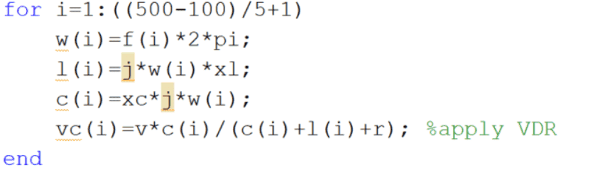

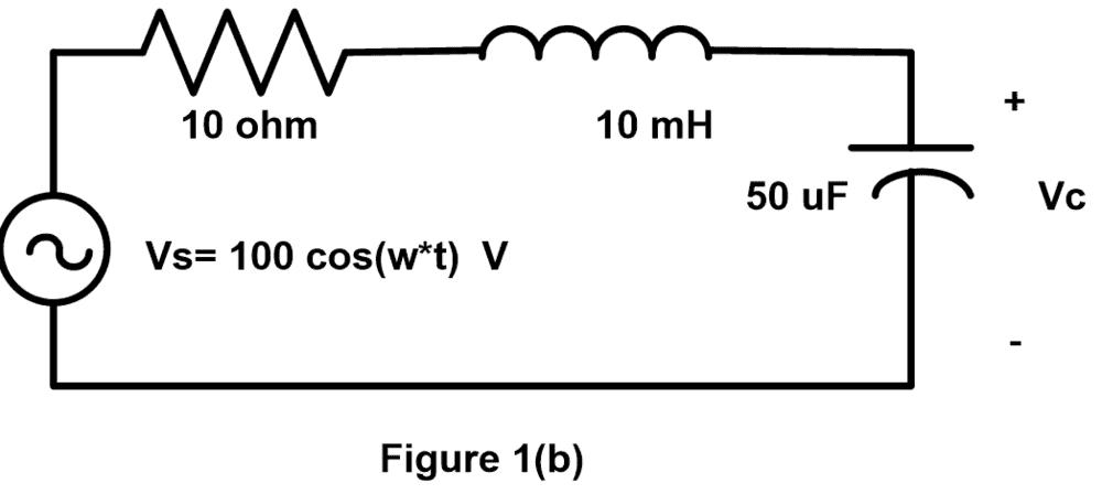

Consider the simple ac circuit of figure 1(b). The frequency of the AC source varies between 100 Hz to 500 Hz. Draw the magnitude and phase angle of the voltage across the capacitor. Try to increase the frequency by step of 5 Hz.
The circuit is attached below.

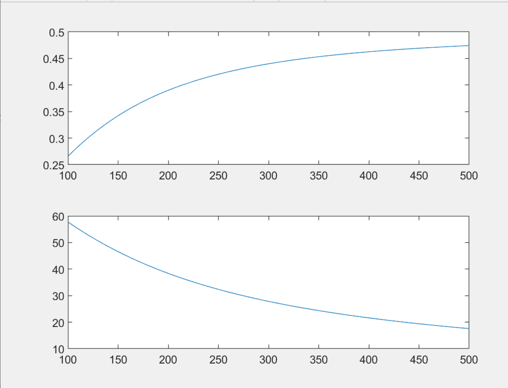

My solution is attached below.
I am not sure if my answer is correct or not , I want to confirm it.
From the code ?
244974
it seems strange to me that L and C are treated similarly ...

C should be = 1/(Xc*j*w(i))

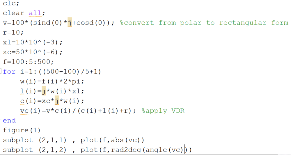

I resolve it again and here's what I got :
Matlab:
clc;
clear all;
v=100*(sind(0)*j+cosd(0)); %convert from polar to rectangular form
r=10;
xl=10*10^(-3);
xc=50*10^(-6);
f=100:5:500;
for i=1:((500-100)/5+1)
    w(i)=f(i)*2*pi;
    l(i)=j*w(i)*xl;
    c(i)=1/(xc*j*w(i));
    vc(i)=v*c(i)/(c(i)+l(i)+r); %apply VDR
end
figure(1)
subplot (2,1,1) , plot(f,abs(vc))
subplot (2,1,2) , plot(f,rad2deg(angle(vc)))

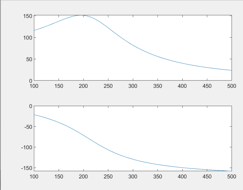

Looks a lot better now !
Checks are 90 degree phase difference at ##\ 2\pi f = {1\over \sqrt{LC}}\ ##
and V(C) dropping off with ##1/\omega^2\ ## at higher frequencies.
