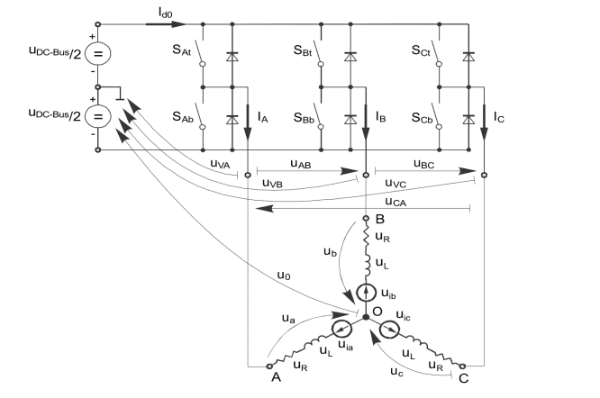

Find the phase voltage and Line-Line voltage relation
Kirchhoff voltage and current laws
The below is the diagram i want to find the phase and line-line voltage relation
Circuit schematic of a three-phase two-level inverter feeding an R-L star-connected load with neutral O, showing DC bus sources, switches S_At/S_Ab, S_Bt/S_Bb, S_Ct/S_Cb, output phase currents I_A, I_B, I_C, and voltages u_VA, u_VB, u_VC, u_AB, u_BC, u_CA, u_0, u_a, u_b, u_c.
I am finding difficulty in identifying the loop and applying the KVL.
One attempt is
U_{VA} - U_R - U_L -U_O - U_L - U_R = U_VB
U_{VA} - 2(U_R+U_L) = U_VB -> eq1
Is my attempt correct? i am not confident please help.
UVA and UVB should actually be equal if this is a schematic of a wye transformer. They should both be 120V. The line to line voltage would be UAB.
Probably a 3Φ motor drive or inverter, since there are ideal DC sources in there. But it could be a rectifier, I guess. Much depends on the switches. Normally KVL would only be applied for a specific switch state since the network changes when switches change.
What is this circuit supposed to do? How are the switches controlled?
Yes it is inverter
SAtSBtSCtU_VAU_VBU_VCU_ABU_BCU_CAUaUbUc
100udcbus/2-udcbus/2-udcbus/2udcbus0-udcbus
010-udcbus/2udcbus/2-udcbus/2-udcbusudcbus0
001-udcbus/2-udcbus/2udcbus/20-udcbusudcbus
110udcbus/2udcbus/2-udcbus/20udcbus-udcbus
101udcbus/2-udcbus/2udcbus/2udcbus-udcbus0
011-udcbus/2udcbus/2udcbus/2-udcbus0udcbus

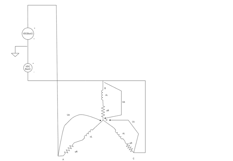

I want to calculate the voltages Ua, Ub, Uc
For the 1st case if i consider
1 0 0 the circuit will be as below
Circuit schematic of a three-phase inverter driving a star-connected load with phases A, B and C, showing two DC bus voltage sources VDCBus/2 and a ground symbol, with Ua, Ub, Uc and winding elements uL and uR labelled.
If i write KVL
a. 1 0 0
VDCBus/2 + Ua -Ub + VDCBus/2 = 0;
Ua - Ub + VDCBus=0 -> 1
b. 0 1 0
VDCBus/2 + Ub -Ua + VDCBus/2=0
-Ua + Ub + VDCBus = 0 -> 2
c. 0 0 1
VDCBus/2 + Uc - Ub + VDCBus/2 = 0 -> 3
Very confusing am i in correct direction? The document is user guide page 51.
