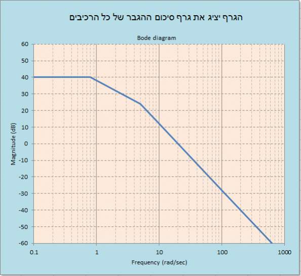

Sketching an approximation of the bode magnitude plot for a given transfer function is a matter of identifying the "corner frequencies" where slope changes (where a new term of the function starts to manifest its effect) and approximating that effect by a change in slope for the line.
I do not understand the top diagram. It seems to show something different.
Perhaps it belongs to a different problem?
Or it is an example of something?
The second diagram looks like mine.
The slopes of the lines are the same.
And the locations of the connections are almost the same.
Note that 0 on the x-axis in my diagram corresponds to ##10^0## in yours.
And 1 corresponds to ##10^1## in yours.
Furtermore my x-axis is at a different dB level. Mine is at dB=0.
Can't explain the slight difference yet, though.
It looks to me as if in your plot the 2nd line is slightly off.
The 2nd line intersects the y-axis at 40 dB, while it should be slightly lower (at 20 log 80).
That would explain the slight differences.
They made an approximation for the 2nd line.

http://img802.imageshack.us/img802/29/bode1.jpg

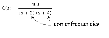

Hi Fp! The transfer function you are dealing with is:
G(s) = 400/❨(1+s) (4) (1+s/4)❩
Notice how I have converted each term involving s into the form (1+s/Ѡ) because when this is plotted piecewise linear it is a horizontal line up until s=Ѡ at which point the graph changes to have a slope of 20dB/decade. For s « Ѡ you can see that (1+s/Ѡ) is approximately 1 and that's a horizontal line of 0dB; for s » Ѡ the 1 term is insignificant and (1+s/Ѡ) is approximated by s/Ѡ, and a plot of s/Ѡ is a straight line of slope 20dB/dec.
So your transfer function comprises the sum of 3 plots:
▸ 100 ...which on a dB scale is a constant 40dB
▸ 1/(1+s) ...which is a horizontal line of 0dB until s=1 then it dives at -20dB/dec
▸ 1/(1+s/4) ... which is a horiz line of 0dB until s=4 then it dives at -20dB/dec
These are shown on the graph you provided above.. (Remember, 100 = 1)

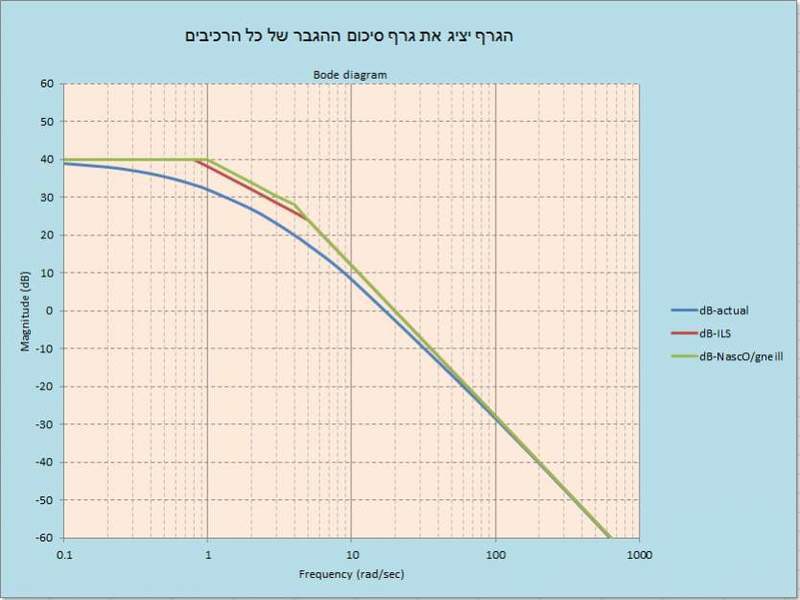

Check this out.
Does this look more like your graph?
(Courtesy of Excel.)To quickly find the corner points there is another trick:

Do those points match the graph?

I haven't been able to follow ILS's "shortcut" method, but here's the amplitude plot with double poles at s=-2. So whatever method you use, to be valid it must produce this answer for 400/((s+2)(s+2)).
Note: horiz scale is Hz, not rad/sec, and Ѡ=2 rad/sec corresponds to f≃⅓ Hz.
I think you'll find that the factored version of the transfer function spells out the poles conveniently in terms of the natural angular frequency (rad/sec).
It's as easy as that.
For single poles the slope increases by 20 db/decade, for double poles like ##(s + 2)^2##, the slope increases by 40 db/decade (that's still 20 db/decade per pole).
