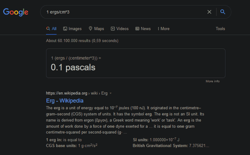

I want to know how to convert dynamic pressure of a flowing fluid into pressure units by which static pressure is being measured.
We all know that a flowing fluid acquires dynamic pressure as a result of this velocity. But the pressure has been known to be the kinetic energy of unit volume of flow i.e. 0.5 times density multiplied by the square of the velocity. I just want to know how to convert that into units that are being used to measure static pressure.

The units are identical. Find out what system your pressure unit is in and then look up what are the units for velocity and density in that system.
Static pressure is measured in BarA, BarG. PsiA, PsiG etc. But, the way dynamic pressure is defined, the possible result will come in units of energy. Kindly tell me how to convert that into units of pressure. Suppose in case of a fluid, the dynamic pressure is 8 ergs. I want to know how to convert that into psi, bar etc. if we know the density and other details of the fluid.
ergs are in the cgs system.
dynamic pressure has units of ergs/cm3 which equal 1 barye
1 bar = 1,000,000 barye
No, you appear to have done your unit analysis incorrectly here. Dynamic pressure shouldn't come out in units of energy, it should come out in units of energy per volume, and with a bit of unit rearrangement, you should be able to find that energy per volume and pressure both are actually dimensionally the same.

Dynamic pressure is defined as ½⋅density⋅velocity2
Pressure is defined as kg⋅m−1⋅s−2
( kg⋅m−3 )⋅(m2⋅s-2) = kg⋅m−1⋅s−2

But the pressure has been known to be the kinetic energy of unit volume [J/m³] of flow i.e. 0.5 times density multiplied by the square of the velocity [(kg/m³)(m/s)²]. I just want to know how to convert that into units that are being used to measure static pressure [Pa].
It is just a matter of unit conversion:
1 (kg/m³)(m/s)² = 1 J/m³ = 1 Pa

If you just want this
T C said:
Kindly give me a clear example. As for example, if it's 8 ers/cubic cc, how to convert it into pressure unit.
then google is your friend.

Use SI units.
Velocity; v, in metre/sec; Density; d, in kg/metre3; Pressure P, in Pa = pascal.
The dynamic pressure will be; P = ½·d·v² pascal.
