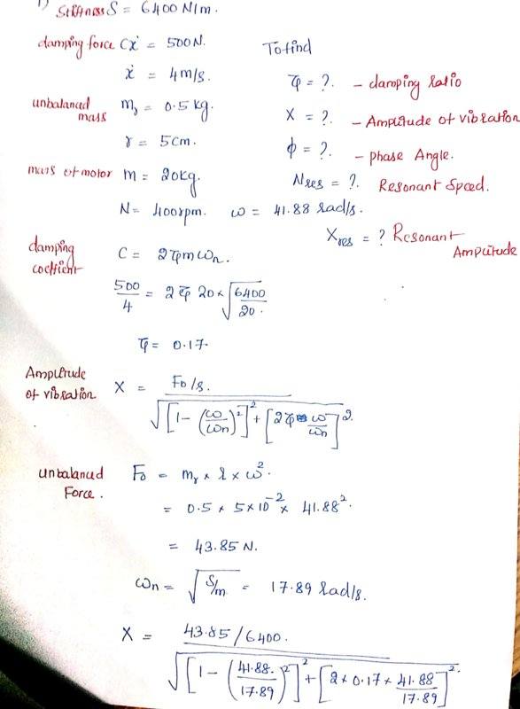

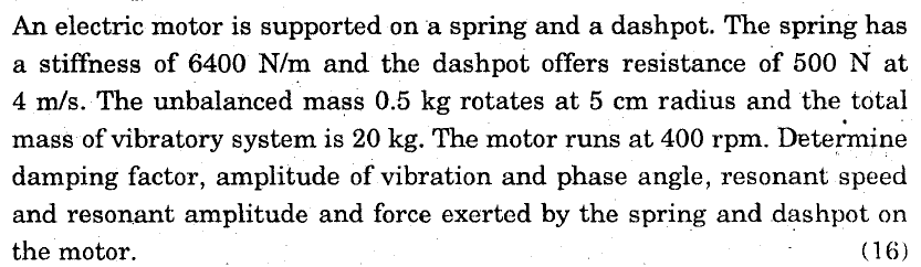

I am looking for the answer for the above question. I solved almost except the last one "Force exerted by the spring and dashpot on the motor".
Can anyone help me to find out the answer for it
Can you please show us the work you've done on this question so far? Then we should be able to help you finish it off. Thanks.

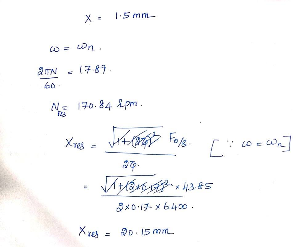

I have attached the image file. i am looking for the answer for last question.
do i share the theory behind this to get better visibility of equations
