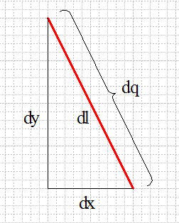

A finite line of uniform charge is on the line joining (4,0,0) (0,8,0) and has λ= 2μC/m find E at (0,0,0)
E = Q / (4 π ε0 r^2)
dQ = λ dl = λ dx
I first notice that r will depend on 2 changing values x and y.
I write an equation for the line.
y = 8 - 2x
I use this relation to find r in terms of x
r = sqrt ( x^2 + (8 - 2x)^2 )
I set up my integral
λ / (4 π ε0 r^2) ∫ < -x , 2x - 8> dx / [ x^2 + (8 - 2x)^2]^(3/2) from x=0 to x=4
when I evaluate I get <-2250 , -2250>
This does not seem correct to me. Based on the location of the line to the origin I would expect my x component to have a larger magnitude than the y component. I am not sure where I am going wrong.

Consider this figure:
(revised image)
Write an expression for dq in terms of dx and dy. What's dy in terms of dx for your line? (think slope).

No, the dq will be λ times the length of the line segment indicated. For your line, for a given dx the length of dy is ...?
I've revised the image in post #4 slightly.
I don't see it. The only thing I see doesn't make much sense sqrt (dq^2 - dx^2) ?
don't answer yet, I didn't see your revision
What's the length of the line segment containing the charge in terms of dx and dy?
What is dy in terms of dx for your particular line? (dy = ?dx)
Substitute for dy and write the length of the line segment in terms of dx only.

Is the length of the line segment dl = sqrt(dy^2 + dx^2)?
Yes. Simple Pythagoras. What's dy in terms of dx for your line?
sqrt(dl^2 - dx^2) ?
No, for your line as a whole: What's dy/dx? So dy = (?)dx.
-2 (from the slope)
Jake 7174 said:
-2 (from the slope)
Yes, so replace dy with -2dx in the expression for dl. Then you'll have an expression for dl in terms of dx only.
So then, what's dq in terms of dx?
sqrt(5) dx
Jake 7174 said:
sqrt(5) dx
Multiply that length by λ to yield the charge element.

So from that,
E = λ sqrt(5) / (4 π ε0 ) ∫ < -x , 2x - 8> dx / [ x^2 + (8 - 2x)^2]^(3/2) from x=0 to x=4
But if I do this I just multiply my answer by a sqrt(5). Something must be wrong with my integral.

Please don't leave me now. We are so close. I know there must be a problem with my integral, I just don't see it.
What makes you feel that there's something wrong with your integral?
Because when I evaluate it I get the magnitude of e field in x direction equal to the y. This does not seem right because E is dependent on 1/r^2. My x component should be bigger I think. My answer is
<-2250 Sqrt(5) , -2250 Sqrt(5)> N/C
I'm not seeing a problem with your integrations. I think it just turns out that the components end up being equal in magnitude.

My answer is
I also agree with this answer.
In fact, I believe that as long as the wire extends from some point on the x-axis to some point on the y-axis (neither point at the origin), the x and y components at the origin have equal magnitudes. A somewhat surprising result!
Very much surprising. It is for this reason I suspect it was assigned. Because I could not believe it in the first place that prompted me to make my the original post. Had I not I would have missed the sqrt(5)
For what it's worth, I get that the x and y components of the field each have a magnitude of kQ/(xoyo), where k is Coulomb's constant, Q is the total charge on the wire, and xo, y0 locate the ends of the wire on the x, y axes respectively.
