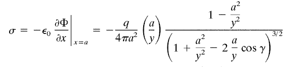

Then he figured out surface charge density by:

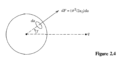

Then he mentioned that the force on unit area da is just :
So this is the part I don't get, I understand that σ *da = dq is the charge on area da, but what is the rest part? I don't really get why dF = dq * (σ /2ε ), is that indicate the E field at da is (σ /2ε )? if so, how do we get this?

1. Say on thin volume surface surrounding da on conductor sphere,
##E=\frac{\sigma}{\epsilon_0}## outside surface and ##E=0## inside surface.
2. Maxwell stress tensor says force per unit area on outside surface is ##\frac{\epsilon_0}{2} E^2=\frac{\sigma^2}{2\epsilon_0}##
3. 1, 2 and ##dF=\sigma da E## tempt us to regard
value of which is exact average of outside field and inside field mentioned in 1.
I do not think electric field at the exact point of sphere charge be defined neither physically nor mathematically.

Further to post #2 I found texts around Fig.I.5 in Introduction of Jackson Third edition is helpful showing microscopic and macroscopic view of plate charge. It says about plate condenser but applies to our sphere.
Though I said electric field working on sphere charge is not defined, we may make use of convention that
[tex]E=H_{1/2}(x) \frac{\sigma}{\epsilon_0}[/tex]
where Heaviside step function_1/2 is 0 for x<0 inside, 1/2 for x=0 on surface and 1 for x>0 outside. As Jackson explained it does not correspond to both macro and micro physics and I take it for practical mathematical convention to meet equation ##dF=\frac{E}{\epsilon_0} \sigma da##.
