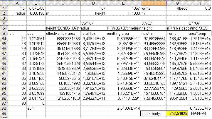

okay I have two handicaps here, I'm neither familiar with the English math terms nor latex. But we'll give it a try.
We take slice of the Earth pie between the lattitude of 'a' degrees and 'a+1' degrees. The surface of the cross section of that slice intercepting the solar flux is average length of the top and bottom length: 2*R(cos(a) + cos(a+1))/2 times effective height (cos(a)*(60 nautical miles)). We multiply this surface with the influx and divide it over the effective surface of the slice:
pi*R*(cos(a)+cos(a+1)*absolute height( 60 nautical miles (without the cos(a)!). Now we use the basic stefan Boltzmann law to calculate the temperature of that particular spheric slice.
We summarize these steps for a=0 to 89, and also sum the temp times surface area divided by sum of surface area (weighted average) to get 251.9 kelvin.
I'm really interested to see what is wrong with that.

Atrtached is a snapshot of the spreadsheet (bottom part) I had to redo it because I worked it out first elsewhere and can't find the original file back. Somehow the rework gives me a new value: 252,5 degrees K. I''ll compare them later.
  • Spreadsheet table of latitude bands from 77 to 90 with columns for cosine, effective flux area, total flux, emitting area, flux per metre, temperature and area times temperature; black body temperature cell shows 252,51025.

okay but what temperature? The actual average temperature is apparently not the same as the temperature following from an evenly radiating shpere.
But, the point is that if you're going to use Stefan's law, you must assume that the temperature is uniform throughout the sphere. So, what do you mean by an average temperature?

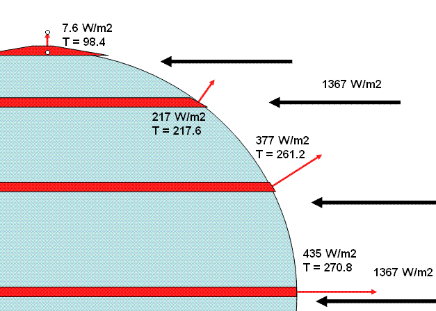

I'm trying to see what happens if you convert the radiations to temperature first for each degree of lattitude and then see what the average temperaure is. An example of four slices for 0-1 - 29-30 -59-60 - 89-90 degrees lattitude is attached.
  • Diagram of a half-sphere with horizontal red bands at four latitude slices, each labelled with a flux in W/m2 and a temperature T; black arrows show incoming 1367 W/m2 sunlight and red arrows show outgoing emission.

Andre, your intercepting area and emitting area are not exact of what it should be, that introduces error. Also as I said above the assumption of constant albedo with sperical Earth is very arbitrary one could argue and the temperature difference is not significant as you presume it to be given all that.
And a one technicall, why is the height in emitting area not corrected with the cosine lat? Is that not saying that the distance between 1deg lat at let's say 70-71 is the same as at the equator?
no, the effective height of the slice intercepting the incoming parallel insolation is corrected for the lattitude with the cosine, whereas the emitting surface area is indeed the complete surface, so the correction is not applied there.
I made an error not showing that in the simple drawing that I attached.
I agree that the one degree slices introduce an error, which diminishes when it is replaced by the integral. I doubt if the error is large enough to explain the difference. Somebody interested to do the math?
Also not sure about the albedo problems. Is anything changing in (bond)albedo between the two methods?
I wrote a program with double precission of those cosine factors and i got 252.71 :D . I was thinking that it could be quite managable to do the integration using calculus technique of rotating curves around y axis. (I will do but when I get to the book, its been a while).

Andre, I am uneasy about the emitting area. The schollary formula implies 4times bigger emitting area. Your formula has 10times biger emitting area (on average). [from 3times bigger to 180time biger at the poles]
You are right, if you check the ratio of the sums of the area we get 3.97 instead of 4. I rechecked my original spreadsheet, that was right, this one is wrong.

Also, the solar flux is now hitting spherical surface, ther should be correction for cos(zenith angle) [this will further cool us]. Albedo must be changed as well but that's the biggest uncertainty how. Its certainly not constant, it needs to be weighted since you get different fluxes and incident angles over different areas. This will indeed produce great discrepancies.

The cosine is there, basically the calculations are truly reversable now, ensuring radiative balance
