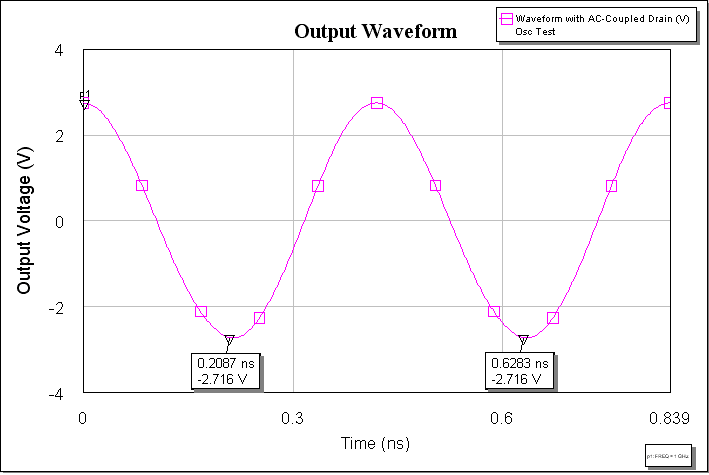

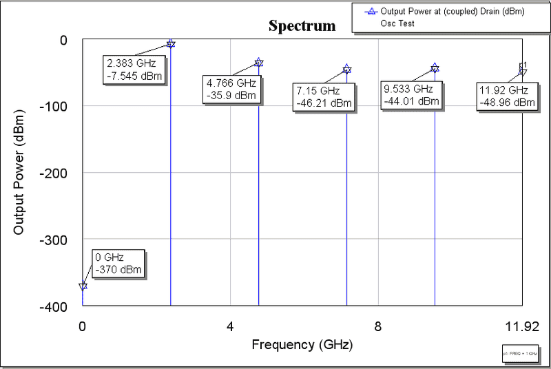

2.4 GHz. No transmission lines in this oscillator, at least not in the designing stage. I've got it to oscillate, but the sine wave I get in output looks like a perfect single-tone sinusoidal. Not only does that immediately raise suspicion, but the spectrum doesn't back that up at all.
I've attached an image of my schematic, my output waveform, and the spectrum. Thanks for the help.
The second harmonic is about 30 db below the fundamental. You wouldn't see much harmonic distortion on the scope. That's why it looks like perfect sine wave.
If you need to match the output to a 50 ohm load, consider designing an L, Pi, or a T match as a last resort. This type oscillator design definitely needs a buffer as any load impedance will affect the frequency, and power output.
