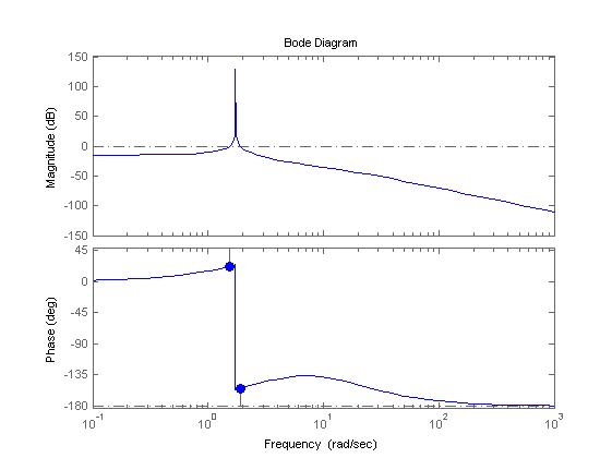

What is the effect on the phase and gain margins of a system when a Phase Lead Controller/Compensator is added?
I have designed the phase lead controller for the system so if anyone wants to see it, please ask
I know, that in general, stability margins are increased, but I am unsure as to why.

to start, why don't you put up a bode plot of your system with and without the controller.

Gain Margin is the amount of gain that can be added to the system before the system becomes unstable
Phase Margin is the difference of the phase at the 0dB crossover frequency and -180

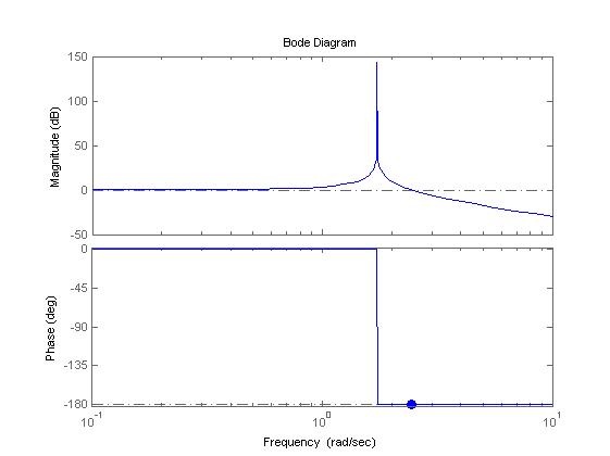

Original:
Modified:

those look like closed loop bode plots, can you show me the open loop plots?
when the phase crosses zero before the gain crosses zero, your system will become unstable. That is due to the fact that you will get positive feedback when you close the loop. once the gain crosses zero, your system is attenuating, and you are in the green.
so your phase margin is how much margin you have in your phase before your system goes unstable. you want a good deal of phase margin in a real system for a variety of reasons.

The answer is contained in the question: A phase-lead compensator adds a "leading" (positive) phase to the loop gain.
If you know that in case of a marginally phase margin the (negative) loop phase is too close to the critical values, it is clear that addition of a certain amount of positive phase (in the critical frequency region around the cross-over frequency) will improve the margin.
