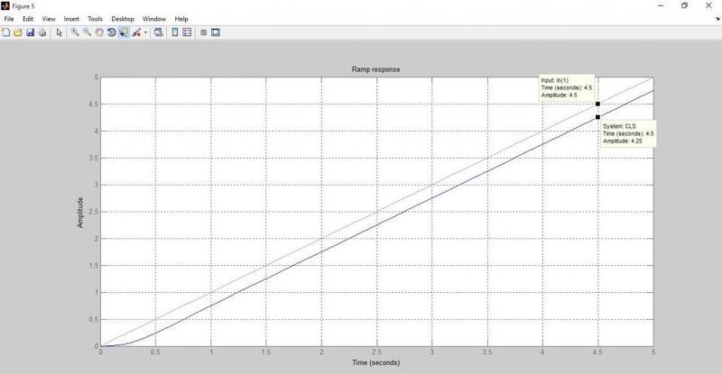

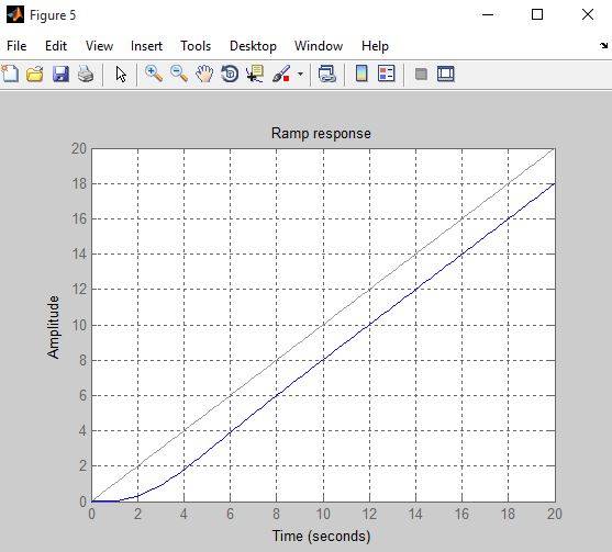

Also, how would I verify the steady state error of the closed loop system after design (from the ramp response? [attachment3]) .
Thank you.
I finally solved it. I assumed the controller gain ##K = 8## to be the inherent gain of the plant and for that plant designed a restructured controller of the form:
##D(s) = \frac{(\alpha_1 s+1)(\alpha_2 s+1)}{(\beta_1 s+1)(\beta_2 s+1)}##
leaving with two poles and two zeros.
Closed loop characteristics were satisfactory.
Thanks.
