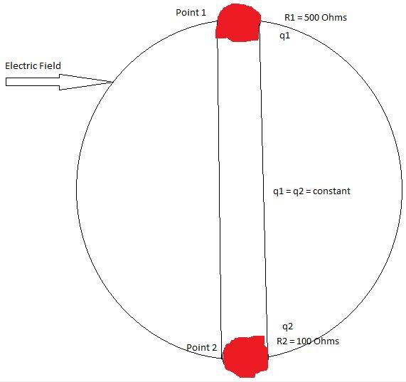

Hey guys!
Any answers will be much appreciated!
The following is a deep conceptual issue I have. The diagram is a bit crude but will suffice I think.
Note: Had drawn the circular 'electric field' at the time, to just help myself over my confusion. Feel free to ignore it.
How voltage increases in an (illustrated) electric field when resistance changes.JPG
As per Ohm's law V = IR. In the above scenario there is greater resistance at point 1 then there is at point 2 (as shown on the diagram). The charges (q1 and q2) and so the current flowing through both points are the same.
Voltage is defined as the strength of an electric field to cause current flow. And current flow is nothing but the movement of charges i.e. Movement of electrons.
So following on, this means that according to Ohm's law of V = IR, there is a greater voltage at point 1 then there is at point 2. Therefore voltage will 'flow' from point 1 to point 2 i.e., From high to low.
This is where my issue arises. With there being greater resistance for the electrons to flow from point 1 how is it that the electrons will go from point 1 to point 2? Shouldn't it be the other way around. I don't conceptually understand how the greater resistance in this way causes voltage flow and so current flow from point 1 to 2. From my definition of voltage given, the greater resistance at point 1 would actually make it harder for the current to flow from point 1 to 2. Conversely the lower resistance at point 2 would make it easier for the current to flow from point 2 to 1.
Yet, and as per Ohm's law, voltage is greater at point 1 so current somehow flows down?
It is kind of a question within another question, so had to explain myself a bit. I am really not knowledgeable in electrical phenomena, so this may very well be a basic matter that I don't know!

Sorry for it not being clear to you. Basically in a nutshell, my confusion is all about how Ohm's law works in reality, i.e., how does increasing resistance increase the voltage at the level of current and electron flow? The equation is V= IR but I don't see how increasing the resistance actually increases voltage!
In the above diagram I haven't shown a battery or a power source but say current was flowing through the wire and one end of the wire has more resistance then the other end, which way would the current flow within the wire? (The current being the same throughout the wire) From Ohm's law we know that V = IR so the end of the wire where there is more resistance would have a greater voltage potential, correct?
Following on simply, voltage flow occurs from a point of high voltage to a lower voltage. If I am right up until now then what I am conceptually confused is how, despite Ohm's Law of V = IR, can increasing the resistance increase voltage potential. Because, resistance would repel or obstruct the flow of electrons. Yet this somehow increases voltage potential?
Voltage is the measure of how much electrons can move (current) so I don't see at the atomic scale, how increases resistance can help in moving electrons and increase voltage potential?
Have tried my best to make it clear, please get back to me.

You have some very big misconceptions about how electricity works. We will do our best to help you get things straight.
What resources have you been using to learn about how basic electricity and Ohm's Law work? Can you give us a couple of links to what you have been reading?
Here are some basic links:
https://en.wikipedia.org/wiki/Ohm's_law
http://hyperphysics.phy-astr.gsu.edu/hbase/electric/resis.html
Resistance does not exist at a point. It exists between two separated contact points on a material. The resistance between those points determines how much current flows when you apply a voltage between those two points.
Could you please read through the links, and post your follow-up questions? Thanks.

Thanks for this clarification, I now see that if there is more resistance between two points then there will be a greater voltage potential.
That's not really the best way to think about it. Usually in these Ohm's Law situations, the resistance is constant and set by the geometry and resistivity of the object, and the current is dependent on the voltage applied, V=I*R. You can apply a known current and measure the voltage that results, but that is a less common way to measure the resistance.
nallur said:
However - I don't understand why resistance doesn't exist at a point. For their to be resistance in between two points there must be resistance at each and every other point (in space) along the way also shouldn't there?
It's better to think of resistance existing across a volume or volume element. In fact, we calculate the resistance of unusual shapes by dividing the shape up into little cubes or thin slices through the shape, and add up the resistance pieces along the path between the two electrical contact points.

Yes, so you're saying that in a circuit for example, the resistance along the wire is the same. The 'points' of resistance in a circuit would then be where the resistors are!
