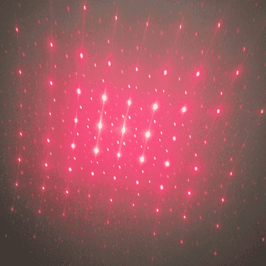

I have a basic question about the effect of transmitting a laser beam through multiple diffraction gratings. Suppose a diffraction grating was used to produce many spots as follows:
Would adding a second grating of the same pattern result in more spots/maximas? If so, would the resulting number be n^2 where n is the original number of spots/maximas? If not, what is the expected visual effect?

Indeed, it's not a typical diffraction grating. This isn't the type with N lines per mm, but rather I believe this is based on FFTs. Still, these are diffraction gratings. The grating pattern looks something like this:
My question is mainly will each beam detracted by the first grating be independently detracted again by the second grating?

The short 'B- rated' answer is 'it depends'. In a sense, you can imagine that the second grating will create a new diffraction pattern for every diffracted component created by the first grating.
Going past that is an I- or A-rated response...
