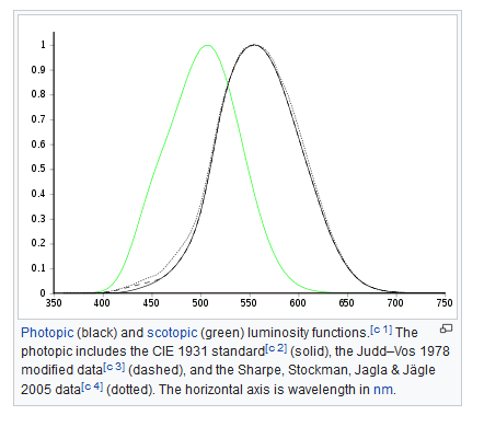

One needs to include the value of the photometric curve at (eye sensitivity) at 650nm. I point out that 550nm light is not red! I assume you mean 650 ??

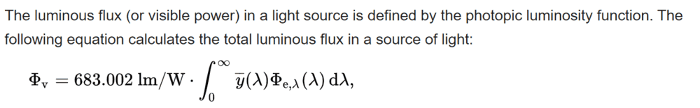

I thought I could help the OP using information from the Wiki article linked by @berkeman . It says
Aha, that number 683.002 looks like a luminosity to power conversion factor, so I googled that. LOL, The Internet sometimes takes us in strange directions. Here is the results I got for 683.002.
  • Texas Transportation Code § 683.002 | FindLaw
  • American Standard 1660.683.002 10-Inch Modern Rain Easy Clean Showerhead,
  • Docket Nos. ER03-683-002 and ER03-683-003 2 Notice of Filings and Responsive
  • Mirror, Chest. 683-002 Dresser
  • Sec. 683.002. ABANDONED MOTOR VEHICLE
  • But it finally found the right one.
Lux - Wikipedia
https://en.wikipedia.org/wiki/Lux
For monochromatic light of this wavelength, the amount of illuminance for a given amount of irradiance is maximum: 683.002 lux per 1 W/m 2; the irradiance needed to make 1 lux at this wavelength is about 1.464 mW/m 2. Other wavelengths of visible light produce fewer lux per watt-per-meter-squared.

The peak of the luminosity function is at 555 nm (green); the eye’s visual system is more sensitive to light of this wavelength than any other. For monochromatic light of this wavelength, the irradiance needed to make one lux is minimum, at 1.464 mW/m2.
That is, one obtains 683.002 lux per W/m2 (or lumens per watt) at this wavelength. Other wavelengths of visible light produce fewer lumens per watt.
