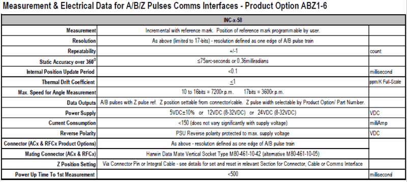

It is an industrial application. I am investigating intermittent failures of the encoder, and speculating that its power supply is not reliable because of sporadic brownouts and/or voltage spikes possibly affecting the AC line during peak operation of a rotating machine (permanent magnet synchronous motor).

What kind of failure of the encoder? Can you give a link to its datasheet? Thanks.
Encoder not powered/measuring anything. Here is the encoder https://www.celeramotion.com/ultra-incoder/ (at the bottom of the page). It transforms the 24 V from the linear power supply to 3.3 V before feeding the sensor electronic circuit.
Sorry, I'm not the sharpest tool in the shed, but this makes no sense. The angle encoder that you linked to is definitely powered, apparently with 3 different input voltage options:
What's "it"?
In your OP you said that you suspected a problem with a power supply that converts AC Mains to 24Vdc, not 3.3V for your unpowered sensor...
