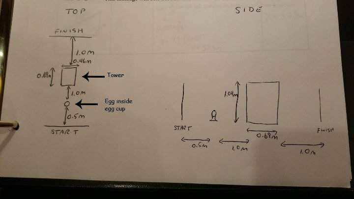

For my Grade 12 Physics ISU, basically I have to build a self-contained device (Can complete the task on its own after setting it up) using physics that can pick up an raw egg inside an egg cup and place safely it on a table/tower 1m away then continue 1m past the table. The egg can't have any cracks or breaks, ideally, when it is on the table. I can use any materials (Electronics are allowed) except dangerous stuff like fireworks, etc. The egg cannot be adjusted in any way before the device is in motion during the test. The size guideline given to us is only that the design has to fit in a standard door frame.
N/A
I was speculating the idea of using falling masses on one end of a pulley system to lift up the egg like a forklift and let it roll along the contraption to fall on the table. As for the motion of the device, I could use a motor, or even a precise push or something like a mousetrap.
I was just wondering if anyone has any ideas in which I could look into Any possible designs or concepts that could help.
Attached is a diagram to help illustrate the project. Thank you!
Here is the diagram.

Hi so an update to this problem, so my physics teacher was telling me that using motors will take awhile to test, so I should start early to get the proper settings. Also, my forklift design has the problem that it will hit the table's surface as it moves towards it, so it cannot move past. Does anyone else have any concepts or ideas in which I can apply to my current idea, or any new ideas that I could look into? I'm really having trouble with this and would appreciate any help!

Sorry for the vagueness. The egg must be placed on the table then the machine (without the egg) will have to move 1m past the table. It will have to pass under the table ideally to make it easy

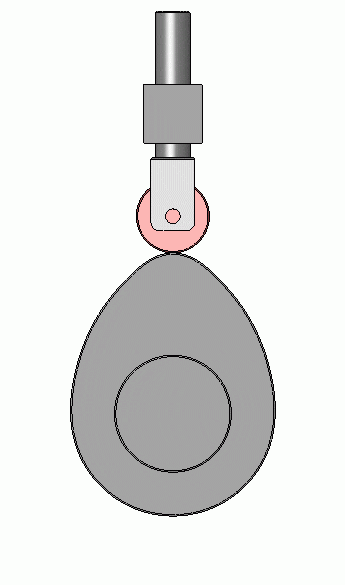

BTW, something that might help you turning steady rotation into non-linear motion is a cam or two, like this:
The great thing about cams is that they are easy to make, tweak and replace. Make em out of some easily trimmable material, like balsa or foamcore, and you can use trial and error to shave them in increments until you get exactly the motion you want.

So an update to the situation, my physics professor told us that instead of having a table which the machine can fit under, the machine will have to go around the table as the table that will be used is one with storage levels underneath.
