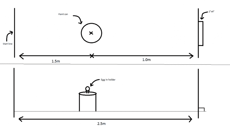

I have a project for physics that requires me to construct a self-contained egg moving device, that must use falling masses to power it. It must move itself 1.5m, then pick up an egg (in an egg cup holder) off of a standard sized paint can, then move another meter and drop the egg off onto a 2"x4".
I don't actually HAVE to use any equations, I just have to build the device and explain it.
I am still in the brain storming stage, and am just looking for helpful ideas before making a decision on what I'm going to build. I was thinking of just attaching a string to the rear axle and then to a pulley on a tower with a weight that when dropped will propel it. My main concern is taking the egg from the height of the can and lowering it, and then dropping it off on the 2"x4". Any ideas would be greatly appreciated.
Thanks for taking the time to try and help.

Welcome to the PF. :smile:
I have a very elegant solution, but it would depend on the exact rules for the contest. Can you post the exact, full project rules?
Hint -- There are different ways to use the energy supplied from a falling mass...
There weren't many rules included in the project, except the ones I've already mentioned and that we are not allowed to use a motor. There was a diagram though, and I've included that along with this.
What do you mean by "no motor"? If there is no energy storage other than an elevated weight to start, why would they care how you convert that stored gravitational potential energy (GPE)?
I believe that if if it is initially powered with the falling mass, I can do whatever I want with the power. I just cannot start it with a motor. What did you have in mind?
