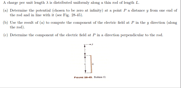

mintsnapple
50
V = q/(4*pi*E_0*r), when 0 is taken at infinity
dV = -E*ds
a. The total charge of the rod is given by Q = lambda*L
So the potential at P is given by
V = (lambda*L)/(4*pi*E_0*y)
b. We can calculate the electric field by differentiating part a with respect to y to get:
E = -(lambda*L)/(4*pi*E_0*y^2)*y-hat
c. Because point P is along the axis of the rod, there is no x-component to the electric field.
Did you have a specific concern?
... for part (a) your answer looks to be the same as if the entire charge were concentrated at the upper end of the rod. Does that make sense?
Try redoing it using calculus and compare.
Ah. So I would need to find a dQ value over 1/(4*pi*E_0*y) to integrate?
So, since Q = lambda*L,
dQ = lambda*dL?
And then the integral would go from y to y+L?

Sorry, what I meant was, I need to find V using
dV = dQ/(4*pi*E_0*r). In this case, r is y, and dQ is lambda*dL, that is, dQ is the charge of a really small length along the rod dL.
So then, can I set the bottom of the rod to be 0, and integrate from 0 to L? Why can't I integrate from y to y+L, if I set the top of the rod to be y, so then the bottom must be y+L?

... no it isn't. r is the distance between point P and the position of the charge element dQ.
"y" is the distance between the end of the rod and the point of interest where you have to find the potential. This distance will be different for different positions along the rod.
Oh if you put point P at the origin, then you integrate from y to y+L yes.

I get the difference between r and y now. So then, if I say z is the distance between point P and some element dQ, then I also define
dQ = lambda*dz
dV = dQ(4*pi*E_0*r) = (lambda*dz)/(4*pi*E_0*z), integrating from y to y+L, does that sound correct?
dV = [strike]dQ(4*pi*E_0*r)[/strike] = (lambda*dz)/(4*pi*E_0*z), integrating from y to y+L, does that sound correct?
... leave off the middle bit because "r" is no longer in the definition of the problem.
You also want to specify that P is at the origin and you are putting the rod: y < z < y+L.
Now you are set up - need only to do the integration.
Thanks! But are part b and c correct? That is for part b, I would just need to differentiate part a with respect to y, and then part c the electric field perpendicular should be 0.
You want to be a tad careful for the last two to use the definition directly.
Particularly for the last one - the answers are not wrong, just not as correct as they could be.
Remember - electric field is a vector, while part (a) gives you a scalar.
Don't forget the reality check - what does the minus sign mean?
Which way should the force point for a positive charge on the y axis?
Is that consistent with your result?
You answer for (c) is a good finesse on the math result - you should still show the same using maths.
